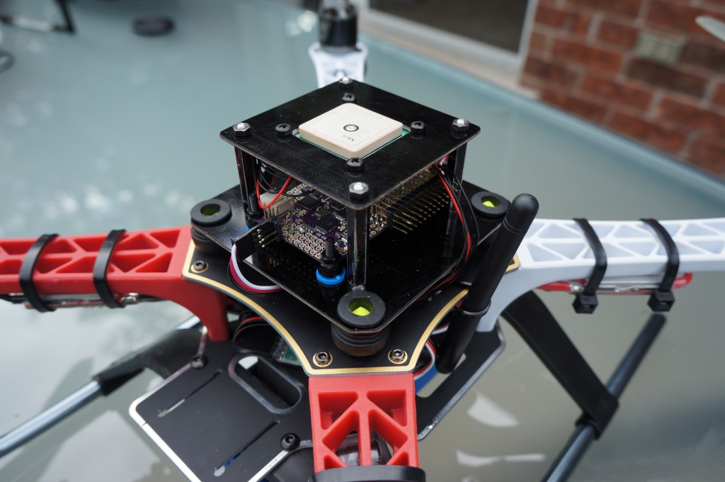

I've got mine mounted like this and it works fine. I could even have those standoffs lower and it would be fine. So it doesn't have to be "on a stick" necessarily.
SteveC
Ok, getting closer. How low do you think you could go with that? I was hoping for something more aerodynamic or maybe temp attach with velcro to only attach the GPS when I need it. Do you see problems mounting then removing when not needed?
