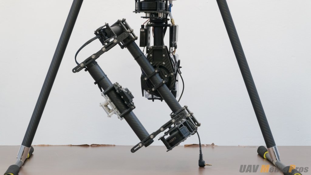

Hi PhotoJ, Sorry it took a few days to get this done.. Real life always in the way of the fun stuff!

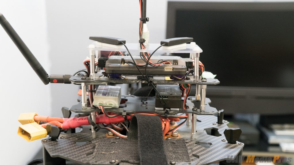

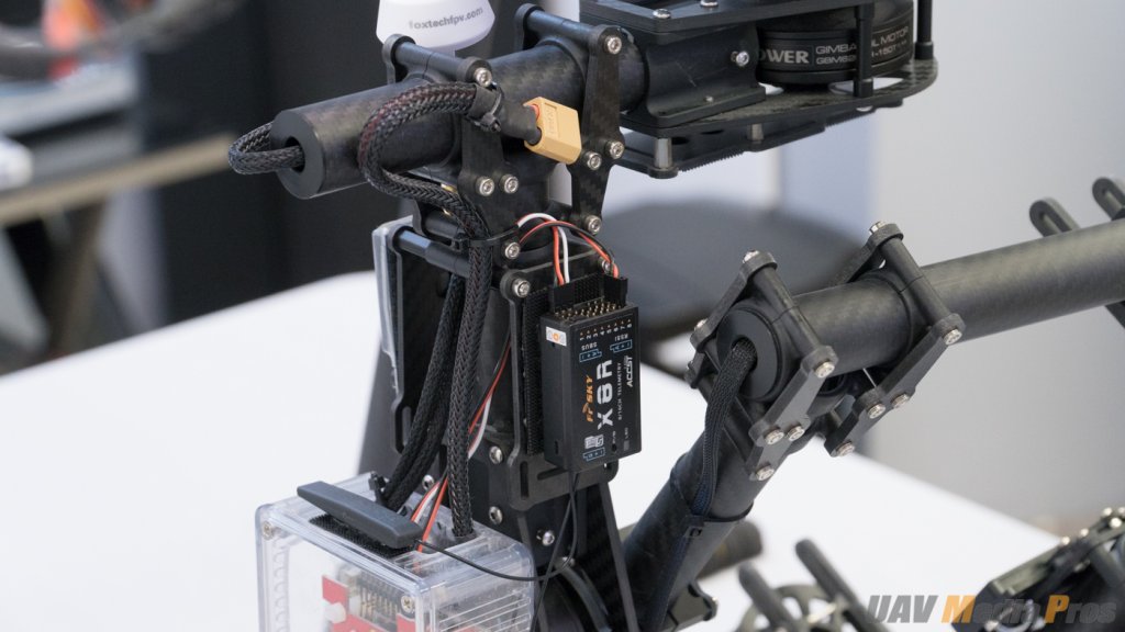

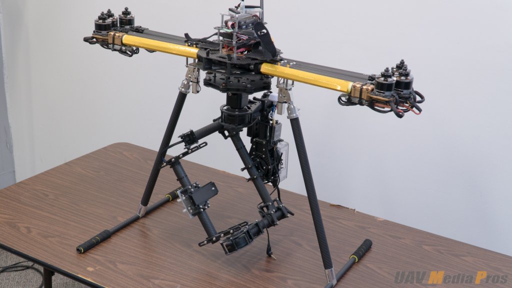

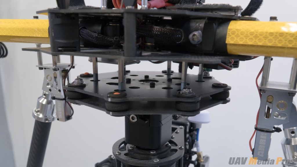

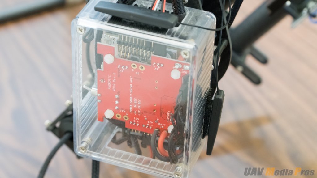

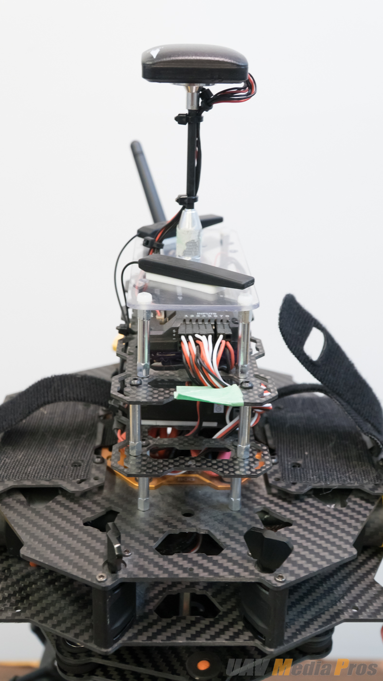

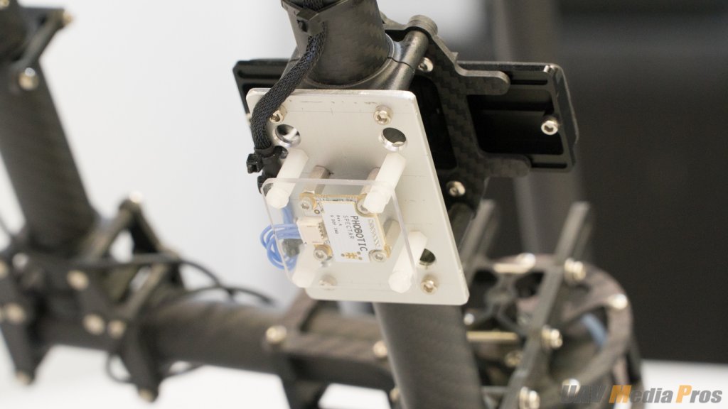

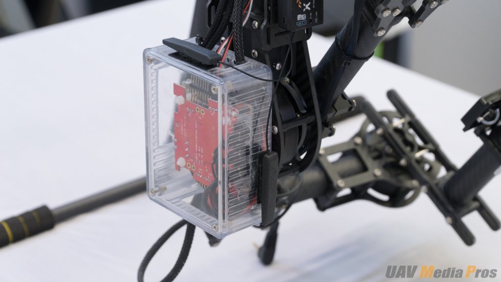

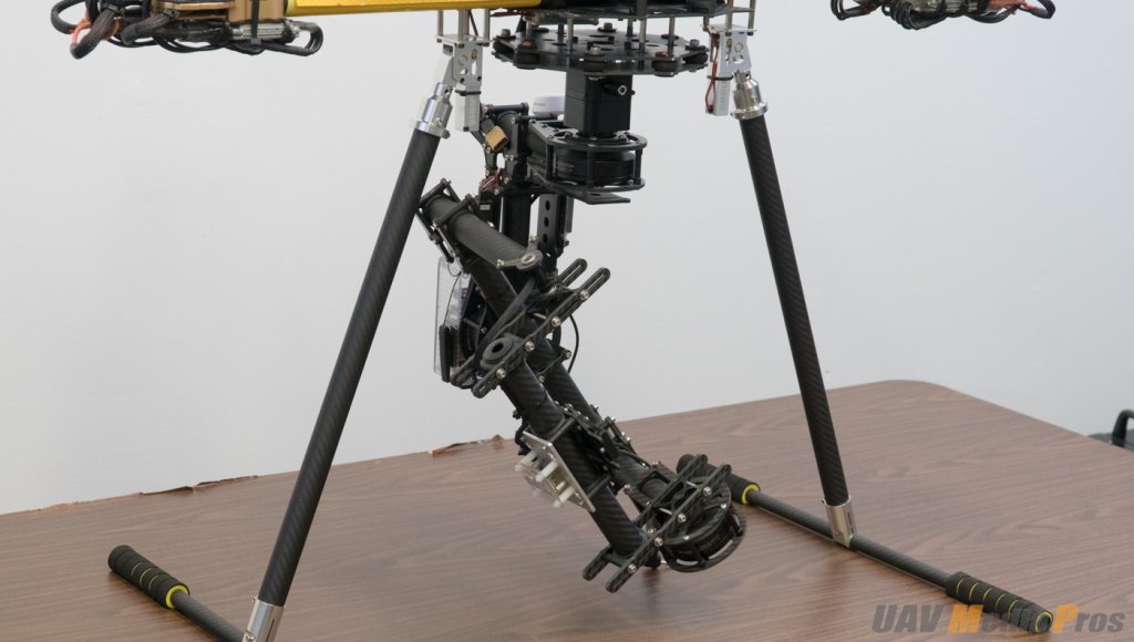

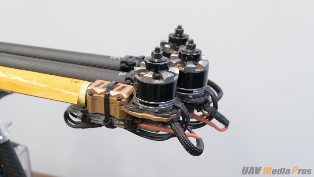

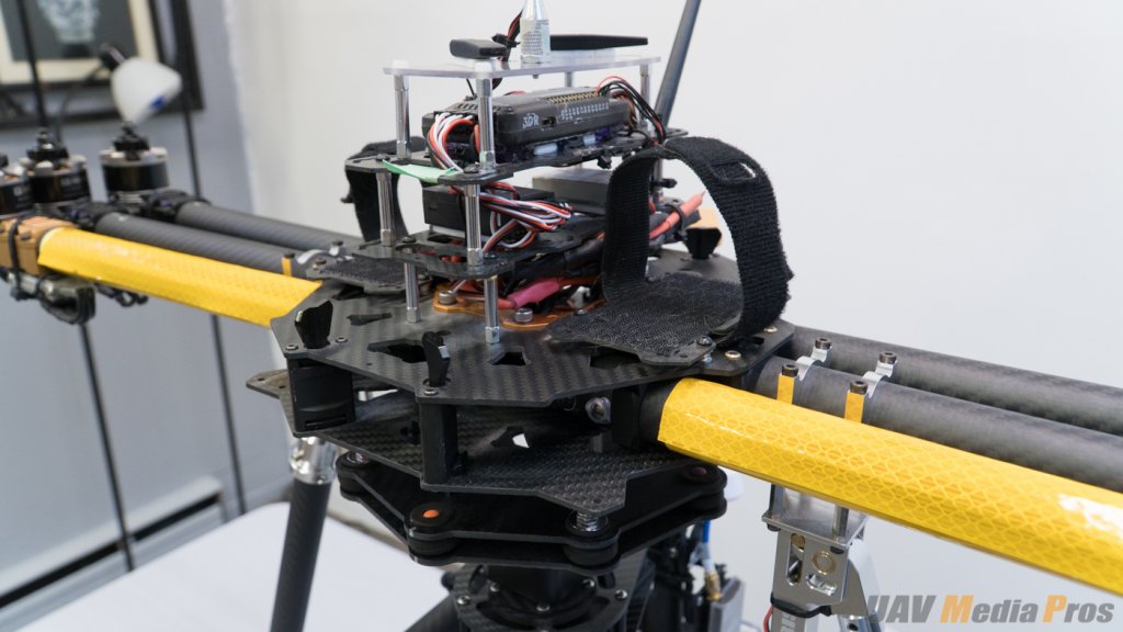

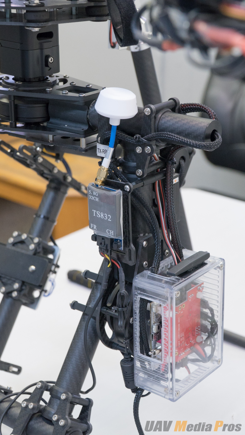

Anyway here are a bunch of pics of my 810. You've probably noticed by now that space is at a premium on these machines, due to the fact you can't mount any electronics between the plates. My main fix for that is the "stack" between the batteries to hold the flight controller, RX, BEC, and antennae: GPS, Ground station TX, and RX. ESC's are boom mounted under the motors for extra cooling. (Note you need to add extra capacitors if you do this). The Damping Plate for the gimbal is from Tarot with some modifications to adapt to the Famous Hobby quick release. Damper balls are stuffed with foam earplugs and drawn down tight with through-bolts to reduce "shimmy".
Motors are T-Motor 3515's
Batteries are twin 5000 mA 6s
The gimbal is a custom unit that I built as a prototype from Famous Hobby parts, and a Phobotic Centerpiece controller. It's my "poor mans Movi"... Superior functionality at a fraction of the cost. It will handle a Canon 5D which I flew for the last two years. I'm now in the process of setting it up to fly my new Sony a6300 .. (As a side note Famous and I now have the BG-001 through BG-005 series gimbals which direct knockoffs of the Movi frames. Coupled with the Phobotic they are easily a direct competitor functionally.)
Hope this helps with your build. I'm happy to answer any questions anyone may have.

Oh one important heads up; The folding booms are threaded into the aluminum sockets and supposed to be factory glued so they don't twist... but the glue tends to fail. So, once leveled, we owners tend to drill a small hole and put a set screw in so the booms can't rotate in their socket. You can see that in my 10th photo above.
