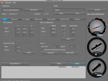

Tried adjusting settings, restore to default, and more power to motors but I'm obviously doing something wrong here. Anyone know any tips or tricks I can check out? Below I've attached my GUI settings. And I can also upload a video if needed. Any help is appreciated. Thanks everyone

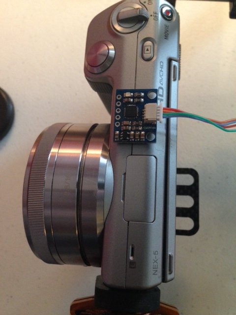

Do you have the IMU Sensor mounted facing up with the arrow on the sensor pointing forward? Twitching is often time caused by the sensor position not being defined properly. Sensor Axis Top and Right X means the sensor is mounted facing up and the arrow forward. Can you provide a photo of the sensor? What type of camera are you mounting? Your power settings are very low. You'll probably need up to 200 for a DSLR on both Roll and Pitch Motor Configuration. The P on the Roll and Pitch might be high as well.

I'm having a hard time finding an appropriate position to have the arrow point forward. It just keeps moving, but I'm working on it. I'm about to take a photo. I'm on a basic setup just a Nex5 w/16mm lens.
Currently my roll and pitch seems to be backwards although I hooked them up correctly. Earlier today I could see each moving, now they are reversed?
The red/blue compass just spins in a circle And now I'm seeing (5) I2C errors

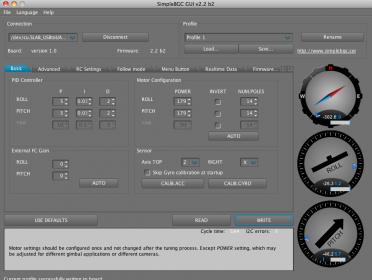

Below is my current setup, picture of sensor on the way. Thanks also for the insight!

Here is the sensor position:

When I hook up my battery (3s 450mAH lipo) the gimbal shakes and twitches. Compass spins around, so I must have something installed incorrectly

Look at the three dials in the GUI. If they don't move the correct direction then the IMU setting is wrong. I suspect you need -Z. Anyway have a play with it until the three gauges move the correct direction. You have to press Save each time you change the setting. But until those three gauges show the correct direction it's not going to work.

My assumption is that my IMU settings are definitely wrong. I've been turning and positioning the IMU all night looking for a solid location and direction to attach it to my gimbal. The arrows just keep spinning around. Currently nothing. Got to be doing something wrong with the IMU here. And probably my GUI settings
