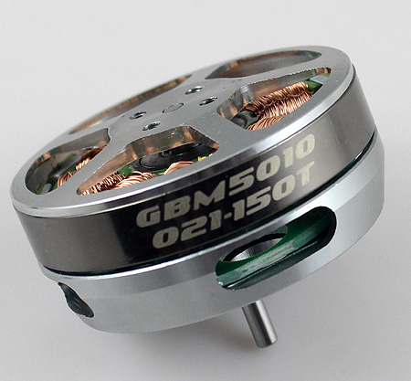

Im using RC Timer Gimbal Brushless Motor 5010 / 0.21mm / 150T with 3s battery. It's not enough during fast forward flight (FFF). Im using Canon 5D
Is it possible to plug it with 4s battery?
Need more torque....

I think you would have more chance of a good response in the gimbal section, but I will try to help you. I have another model of gimbal which also uses the same motors and the guy who sells my gimbal recommends only 3S or 12v. The motor itself may be able to take over 14v but your board probably won't. For a 5D, you're probably on the limit of this motor's capability so I'd try to tweak PID settings first before jumping to a bigger battery.
