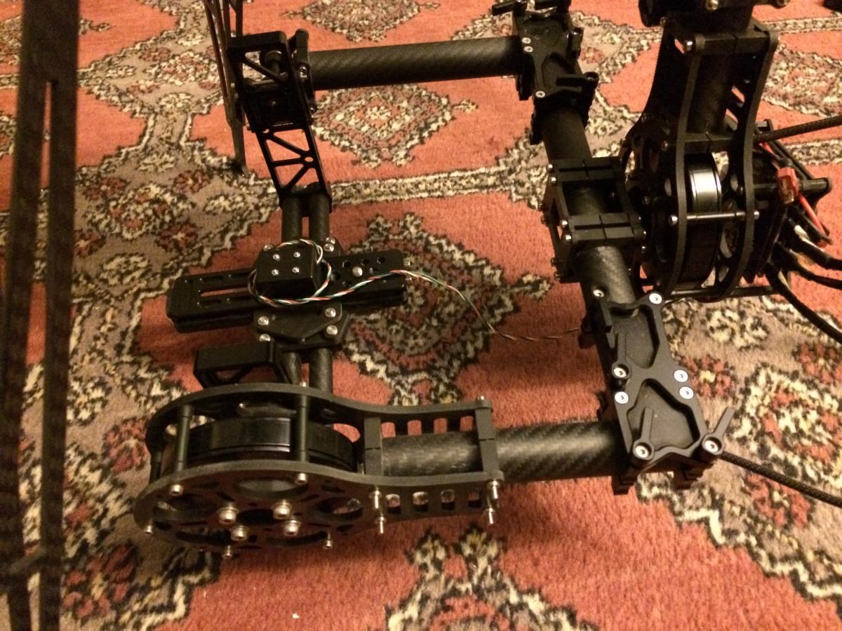

It certainly seems like it's related to wind. I'm new to gimbals, but I'd say I'm balanced. I'm using a GoPro2, and when the gimbal is unpowered the unit stays balanced pointing straight ahead.
When powered, I can blow on the camera with no ill effects. I can tap on the gimbal and it seems to give sufficient resistance to handle a little wind over such a small surface area. I'm unable to replicate this problem while not flying.

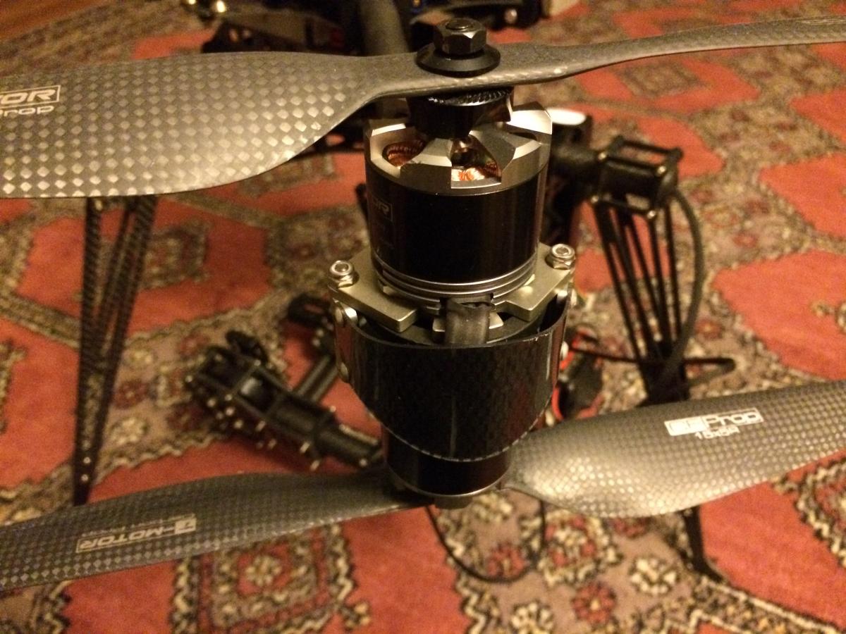

Props are balanced, but motors are junk. (NTM) Vibration could be an issue, since I actually don't have any vibration dampening between the frame and gimbal. But then, why would this only become a problem in the wind? Low altitude slow flying seems fine.

Looking at your first video I'd say look at re-mounting the IMU to try and isolate it against vibrations better and check the prop balance
Padding the IMU might be an easier task to start with. I'll try that tonight. Sigh... too few hours in the day...

The balance is critical and there are 3 axis to balance. If you move the gimbal to any position the camera and gimbal should stay in that position. It must not return to level. The 1st axis is roll, then pitch and finally the cog of the camera in the gimbal. Its the cog balancing that catches people out. If the cog balance is out then wind will become a problem.

Well I've got a thin strip of foam under my gopro.. which lifted it just the right amount to be truly balanced. (and supply some vibration buffering to the camera)
I've also remounted my IMU with some foam. At first it was allowing for too much movement which made the gimbal go crazy. I compressed it a bit with a zip-tie and I think that's a good compromise.

As it turns out, I also had the IMU sensor set incorrectly. When I pitched the camera down, the sensor would think it was pointing up. I also resolved that.

Just to follow up on this... in case anyone else is using this for troubleshooting on their own gimbal: The real problem with my setup was not vibration to the IMU, or even balancing for that matter. (though both are important aspects of course) It was most likely the fact that my axis setup was wrong in the gimbal software. My sensor thought I was pointing up when it was pointing downwards. Rookie mistake!
