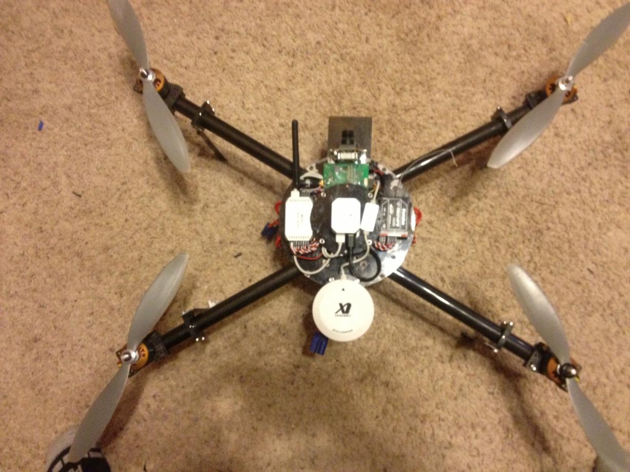

just finished cleaning up some of the wires. Trying to get a nice clean install look. I tried to hide as much as I could.
Mounted the GPS puck on the back deck instead of on the pole. Seems to work fine. It gets a GPS lock within 4-8 seconds every time.

ViQuad Your install makes me a little jealous. My quad with Naza V2 is a bit cluttered when you look between the plates....My x8 is even worse. What motors, battery, and flight times you getting with that setup?
Are the rails that your gimbal is mounted on part of the 650?
