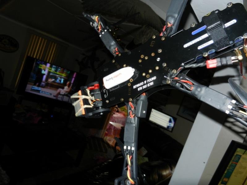

Think it's time to see some close up pictures of your set up. That could really help out.
Another thing that comes to mind, are you sure you have the signal and ground wires plugged into the Naza correctly, not upside down?
Thinking here out loud,,,, do your other two motors spin up?
If so, I would recommend unplugging all your esc's from the Naza, take one that you know works, and plug it into a Naza port that doesn't, see what happens.

i think i've tried all possibilities: brown wire up, orange wire up, with and without the red wire connected but the motors just won't start. actually none of the motors spins with the naza connected but all of them do when hooked up to the rx directly. i'll get some pics today and post them tonight. i just hope there will be something easy to pick up on :tennis:

here a picture from my setup. to make it easier to see i pulled it out of the frame. the colours are as follows: receiver-orange on top (due to the plugs with slot), receiver to naza- brown on top (due to the plugs with slot), naza to esc's-orange on top. for naza to esc's i tried both possibilities (orange and brown on top). i set up the esc's several times and they work just fine when directly connected to the receiver. i hope you can spot the fault although the sharpness is getting pretty bad so small.View attachment 5814
