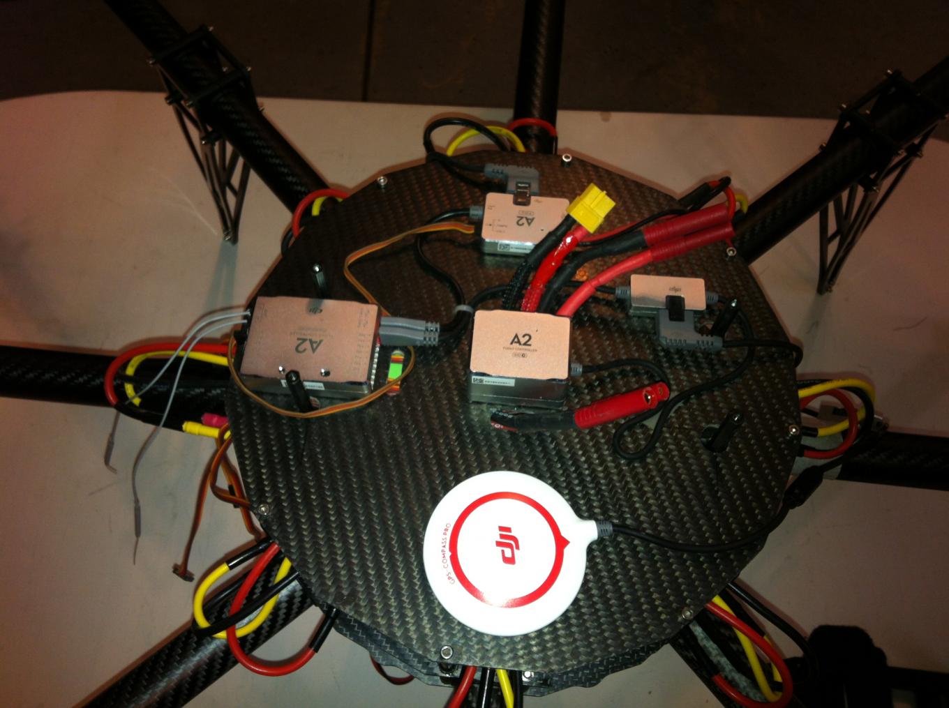

The ability of a tube to resist crushing or rupture is referred to as the hoop strength. The need for a quasi-isotropic cf fabric layup is applicable to cf plate but becomes much less relevant when the structure is tubular. The epoxy is simply a two component plastic such that CFRP stands for carbon fiber reinforced plastic but you already know that I am sure....
Where flat plate material is not used for structural integrity such as for a base for only mounting the electronics the puncture or hole tear strength is of no concern such that sandwiched plate materials provide all the strength required. In my case I creates a cf plate with an aircraft grade inner plywood layer to help to minimize both cost and weight since CF is so expensive. Plate strength and stiffness is primarily determined by the bottom and top layers, the inner layers provide almost no benefit. Here is a photo of the sandwiched plate created using vacuum bagging View attachment 15437
