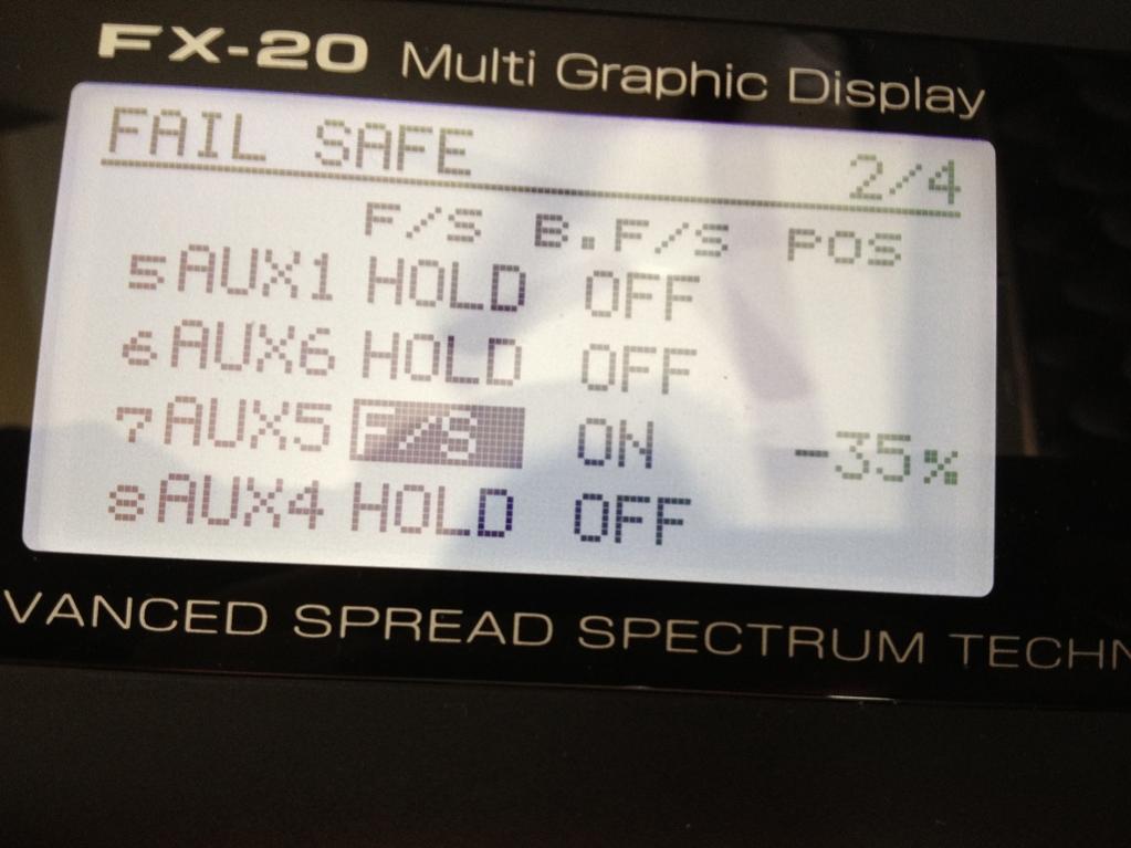

It's actually very simple. I use channel 7 to switch modes, and all I had to do for failsafe is shown in the photo. Turning the TX off will switch this channel to 35%, which is the failsafe region.
Again this is for WKM, so it may or may not work for WKH.

Don´t know if it´s my age, my stupidity or just numb thumbs but when I set the end points for the 3 way mode switch ch7(all three modes are working) then go to "F/S" ch7 and change end point it throws out all my modes and nothing works right.

I'm using a T12FG and is using Ch7 (SE Switch) for flight mode. I noticed in Fail Safe, I cannot dial in the failsafe percentage... I can only program in one of 3 switch positions (in my case +80, 0, -80) for failsafe. I guess I can first adjust endpoint to 35%, go into Failsafe and set that 35% point in failsafe, then go back to endpoint to adjust back to +80 but is there a easier way to do it? Can the F/S Position percentage in failsafe be manually put in?
Ken
