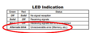

Not sure what happened here, the change of battery and a few tweaks to the gains, but the real problem now is the ERROR CODE.. Red and Green alternating lights on the R2008SB.
When connected via USB cable to Naza software, the Tx is glitchy and connects then disconnects repeatedly. when R2008SB is green the Tx works, when its red the Tx doesnt transmit or the r2008sb is not receiving.
