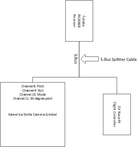

I installed the Stella Gimbal to my Futaba 8FGS with a S.Bus splitter. When I change the function control on channel 9 it changes channels 10-12 to match. How do I get them all to change separately so they operate the Stella on channels 9-11? Here is my layout.

I am struggling with some similar challenges right now.
One has to sit down with a pencil and paper and think really hard on how to map it all out at the RC transmitter end first.....
Futaba configuration is not user friendly by is extremely flexible if you can stay on top of it. I call it "User-Hostile"!
The DJI Assistant configuration is dead simple in comparison but not before getting the Futaba Xmitter issues sorted out first.
Check out the support directories on the Futaba-RC website for some better insights.
