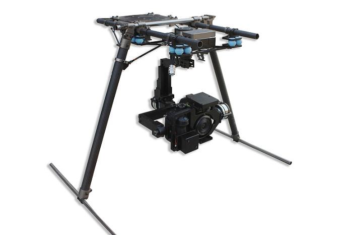

How big was that camera?! No wonder it lost control, probably at max thrust just to keep it in the air with all that weight.

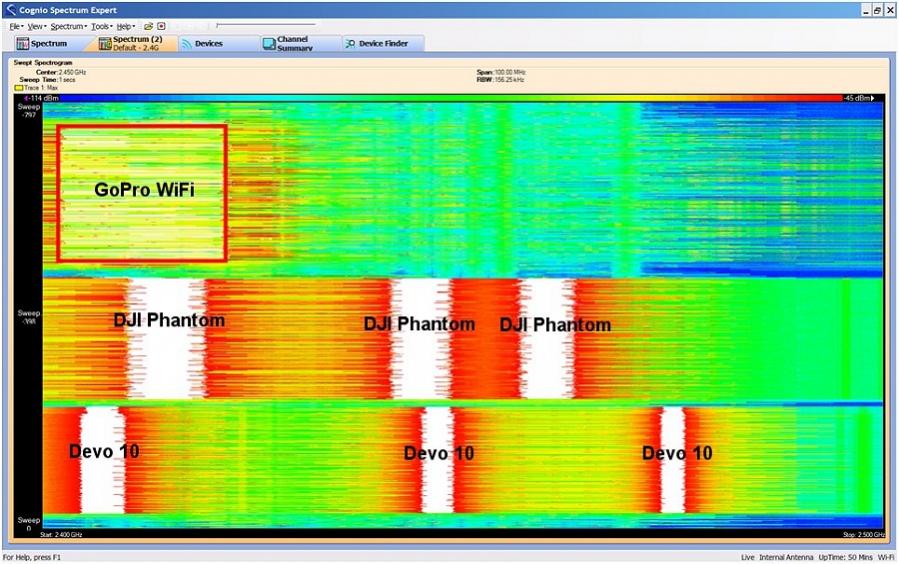

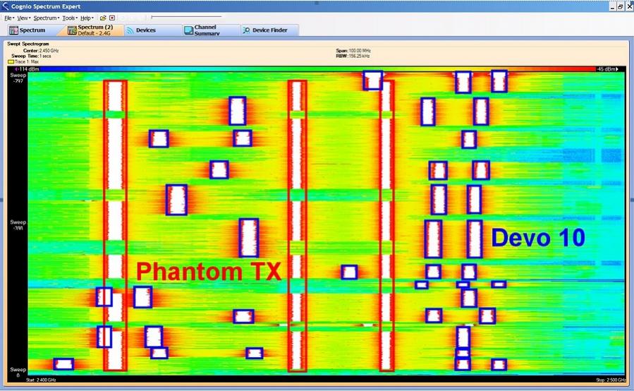

I do a lot of RF analysis and as soon as there was speculation that the GoPro wifi was interfering I scanned the Phantom TX and GoPro.
The big issue is that the Phantom TX is a fixed frequency TX. The GoPro is out of band but if sitting right under the Phantom and at a distance the signal can get walked on. I posted a graph of a frequency hopping TX and they are your best bet. I posted another graph of the Devo 10 being turned on and off while leaving the Phantom TX on, a very inexpensive TX that shifts it's channels as soon as it sees interference.
That video fly-away was hardly over weight. These are loaded up with GoPro's , FPV and dual batteries. It's hard to say but he definitely lost all control. It wouldn't even respond to stick movement and he gave up trying.
That video fly-away was hardly over weight. These are loaded up with GoPro's , FPV and dual batteries. It's hard to say but he definitely lost all control. It wouldn't even respond to stick movement and he gave up trying./QUOTE]
I won't even begin to decipher those graphs. Did you ever do any analysis on Spektrum and Naza?
Let me help with the basics in reading them and yes, I have blasted the NAZA with RF and tested it in a tethered environment. It is more affected by heat, vibration and magnetic interference. I copper shield mine from now on.
Concentrate on what mainly looks white in color, that is the strongest portion of the spectrum. The mini pics are just for reference so look at the above post for a larger pic. The graph draws from the bottom up over time.
View attachment 15061In the first graph I ran the spectrum analyzer in a very noisy RF environment. Bits of 2.4GHz RF spread across the entire spectrum If that's all I see it is safe to fly there.
Then I turned on the Phantom TX and linked it to the Phantom. The Phantom broadcasts across the same 3 fixed channels. If another fixed channel device is in that frequency you have a problem.
Next I turned on a true frequency hopping TX that uses the whole spectrum.
View attachment 15062In the second graph I turned on the Phantom TX and turned on an inexpensive Walkera Devo 10 transmitter to show no matter how many times it was turned on and off, it always chose an 3 open channels to broadcast at.
This transmitter has never resulted in an aircraft flyaway or any abnormal flight. I also have a Hitec Aurora 9 and Futaba 8FGHS Super.
View attachment 15063The third graph is the frequency range that all GoPro Hero 3's transmit at. It is a very wide and weak spectrum. It does land right on top of one of the 3 Phantom frequencies. The Devo 10 spectrum was turned on with everything off to see where it would go. The transmiyyer has to be turned on after all other RF devices have been booted up so they can move to a clear channel if they are capable of that.
