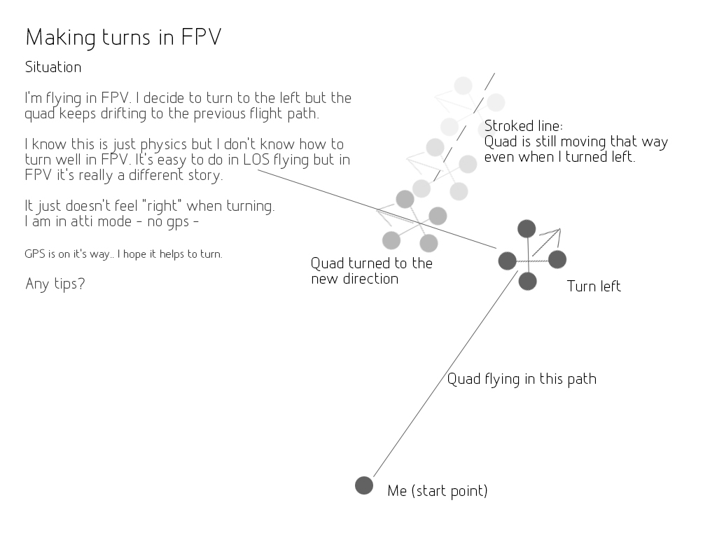

FPV Turns make me crazy (including raising heartbeat)
Jessestr
I really have a though time to make turns with my quadcopter in fpv. LOS is much more easy to take a turn like this but in FPV it just doesn't work.
Following image describes my problem!
Any tips? Thanks!
BorisS
You really shouldn't fly FPV in GPS mode its just have the fun ! But its a good feeling to have the module on for safety reason and in situation were you want the bird to hold position or to come back etc.
If you yaw left you will have to actively work against the initial direction of the copter with aileron and elevator which will result in a curve but not in a point turn ! It like fighting for the direction you turned the nose to ! But than again not pushing it to far to make it a unsmooth flight and curve
Do you have a video so we can see were what you mean exactly ?

So far 90% of my flights have been in Att mode and making forward motion turns isn't too hard.
Check out the vids I have posted so far in YouTube

Well I LOS I kick in with pitch & roll to get a nice turn which works great.. I know I have to do this in FPV too to make a nice curved turn. But my question is if you have any tips for getting that curve nice.. Sometimes it really starts drifting and drifting and drifting...

to do smooth turns in fpv is a bit like ice skating at any speed at all. Winds really make it hard.
the overall smoothest i've gotten them yet is to always push forward on the stick,,,,, never let up, give it a little roll to the direction you want to turn but then follow up with a slow steady yaw and it'll follow it right around, the other one i do is forward stick then pull back on the stick treating it like brakes, and increasingly pulling back, then spin it around...... you could do that in a 90 degree turn to, but it'd be harder.....
3:10 other than the little bobble from letting up and remembering nose down,,,, nailed it. That other one is 4:10..... it's like a bunch of breaks then turn, that works 90 degree really good, but timings everything on when to let off the brakes and it'd be more of a yaw till the right direction then alot of forward.....
Midwest rob has some of the smoothest long sweeping turns. there inspiring

The turn on 4:10 looks better for flying in small places... That's the one I like to use when I'm limited in space (getting near a tree or something and you want to turn back .. just an example)
Thanks for showing! Have to train this.
