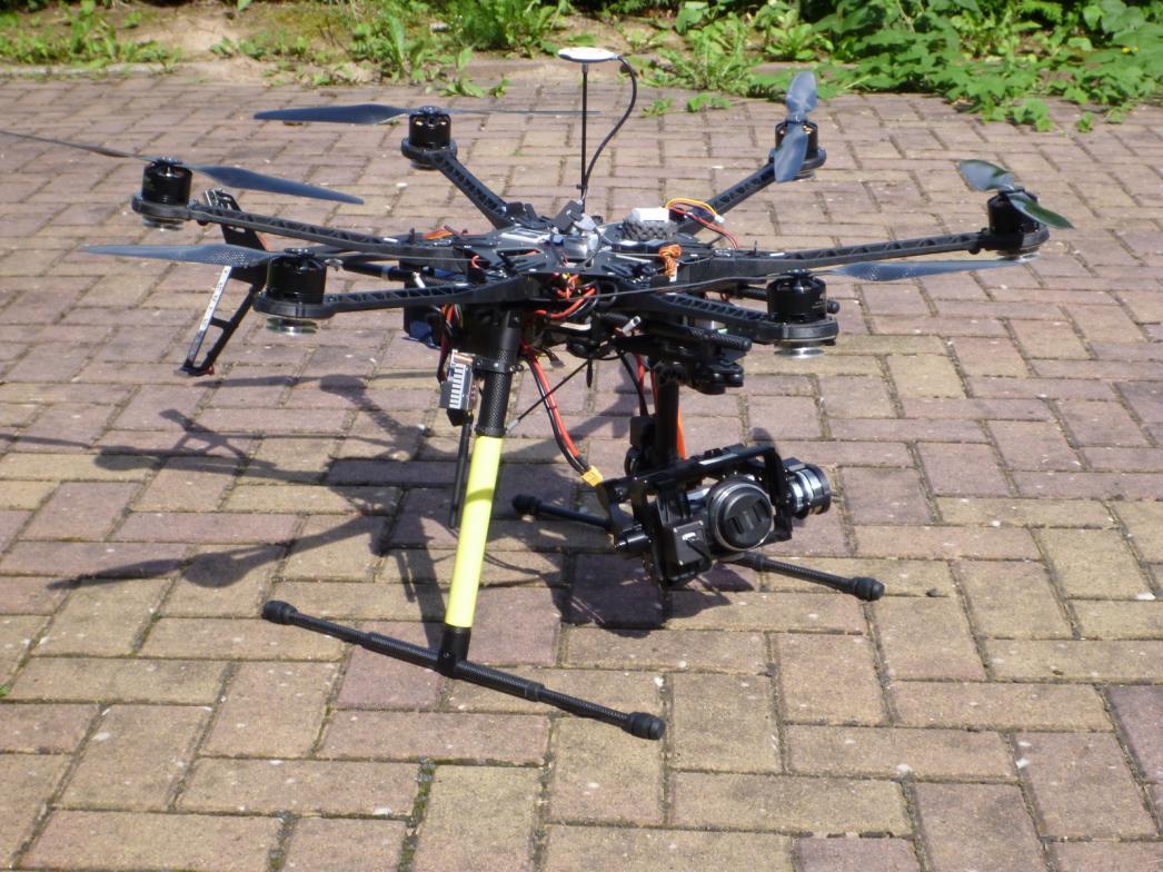

This is my finished S800 with Zenmuse. flying weight is 7.1kg (complete with Waypoint, nav lights, etc). I have done the required re-work and this thing is awesome. It is soooo stable.
This is the first test flight with the Zenmuse....unbelievable how stable this is, there is no post processing..straight from the camera. At about 8 minutes into the video I start shaking the S800, you can see how stable this setup is:

I have "personally" done the required re-work to the ESCs and they run cool. Before the re-work I machined some heat sinks which you can see in the photo...attached to the underside of the ESCs. These are not required, however, i can't remove them because they are attached using thermal epoxy :-(
HEX junky
As per the DJI service bulletin. Remove 6x surface mount resistors and solder jumper wires in their place. The resistors are very (very) small, this is not for the faint hearted. If you are not good at PCB soldering or have the correct soldering iron, then DJI or service centre should carry out the work.

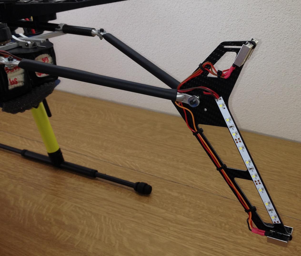

Hex Junky, in the picture, what do you have mounted on the rear of your S800? Rudder? Stabilizer? Purpose? Got another shot of that?

This is nothing special, I have been flying RC helis for over 30 years, however, when it comes to multi rotors I am still a little worried about orientation at distance. So, I have mounted a rear fin and added 3watt led lighting units, just to aid me. It has no effect on the flying (adds about 150g)....and maybe I don't need it...one day I'll remove it and see. I must admit that it's not such a big issue now I have the Z15 mounted.

I see the new battery tray there... when did you get yours? Anyone else get theirs yet?
