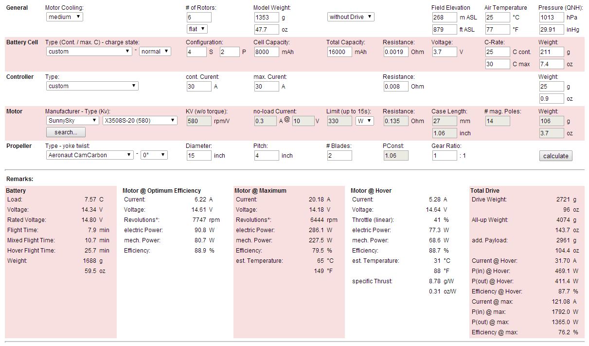

By using the Tarot 680 arms on a Tarot 680Pro frame, I'll be able to support up to 15-inch propellers. I've seen people post similar builds, but they are using a 15x5.5 prop which appears to put me over the max wattage the 3508S-20 580 can support. Also, based on my calculations, it looks like it may even be best to leverage a 14-inch propeller instead of a 15 inch just to keep high-load efficiency more in line.
This build (either 14inch or 15inch) should be able to get me somewhere around mid-20 mins of flight time with plenty of available thrust for lifting some heavier things occasionally. It is also likely my all-up weight will change slightly as I add in some misc items like lighting.
Am I missing something in terms of why some people are using 15x5.5x on a similar setup? Or perhaps does anyone have any recommendations as to changes I should make before I pull the trigger?

Also - adding my current calculations.
I think It'll look something like the below, but I may go with 14 inch props?

Cool~ If you don't mind me asking, which pitch did you use on the propellers? I'll likely use smaller propellers to start, and then test/tune using a few different options. So far I'm thinking I should use 15x4 (or lower pitch) for endurance flight, and 14x6 or so for lifting things like waterballoon bombs and such.

Im using APC 12x3.8 right now. I have a bunch of props to try of various sizes/materials that I've grabbed when good deals came up, and a freshly build bench thrust tester to try them on. I'll be reporting the findings as soon as I get the 580kv on the bench.
i think the smaller props will handle wind better as well, which is something that we have to deal with here in Vermont, almost always.
