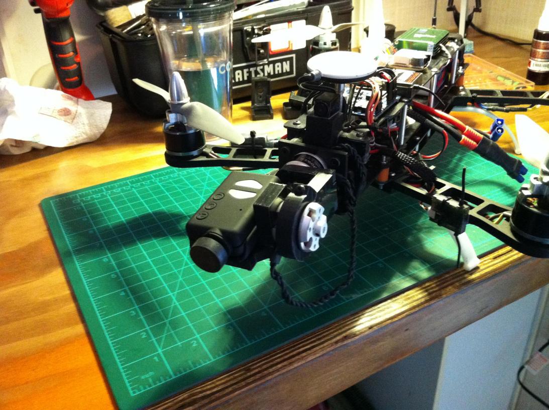

The frame is gonna be carbon fiber tubes sandwiched between 2 CF plates with a 3d printed abs plastic hub in the center. I'm going for a 660mm wheelbase. The motor mounts on the end of the arms will also be 3d printed abs plastic. Similar carbon fiber/metal frames weigh around 600g, I'm pretty sure I can get mine down to 500g.
Those motors with those props are supposed to make 1320g thrust each at 14.8v drawing 8 amps at 100% throttle, x4 is 5280g max thrust, /2 is 2640 AUW. So far all my parts add up to 1600g, + 100g for wiring and etc is 1700g, so payload should be 940g, plenty for what I need. My expected payload is just a 170g digital camera modified for IR, I may add an fpv system later. Am I correct in thinking that even though it is a large rotor/low kv design flying it at almost 800g below max AUW should make it fairly maneuverable right? Like I said i'm a noob to this so if anybody sees any problems or can suggest a better setup please let me know!
