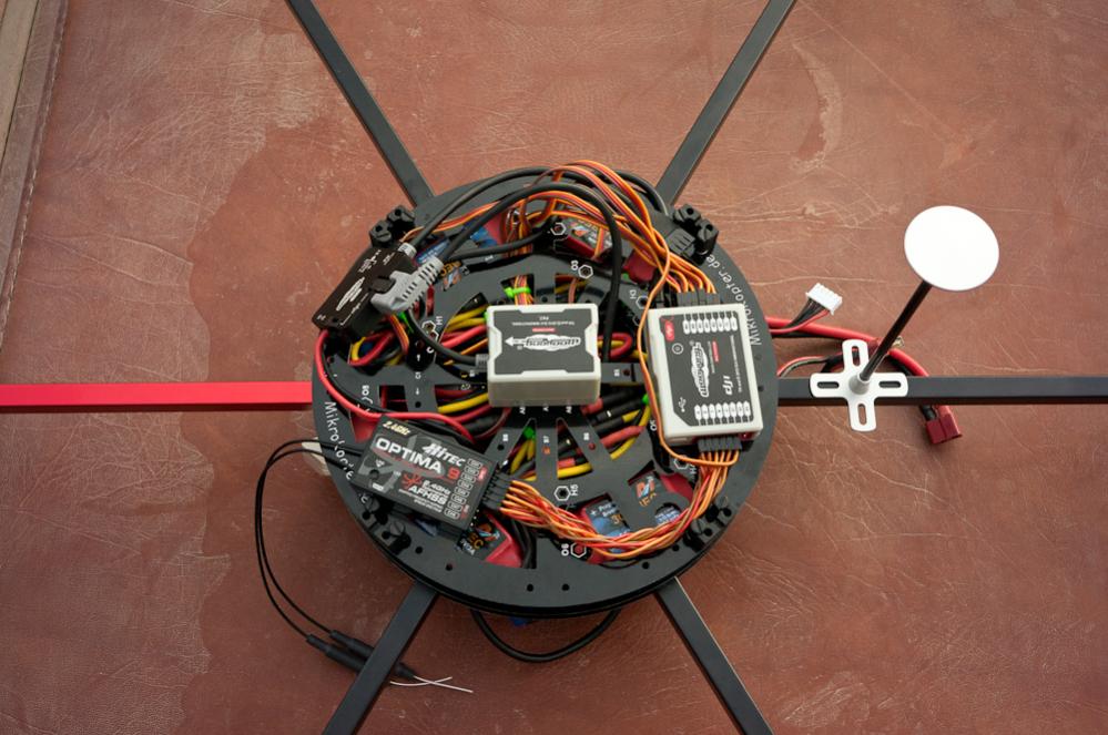

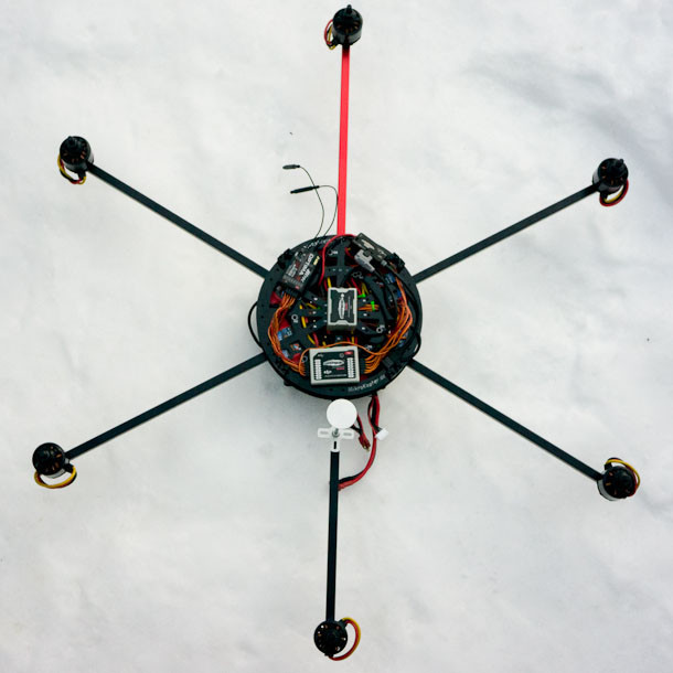

So I am finishing up my MK Hexa XL build using AVROTO motors and Maytech esc's. I am new to the WKM FC and have read the latest WKM manual V2.1.
Couple of questions.
First in regards to where to mount my GPS and what size poll to use.
In the picture I have attached I have the GPS placed on the rigger M4, is this a good place for the GPS to be? Also which length poll should I use, the WKM comes with 3, short, medium, and long.
Secondly, I have mounted the IMU directly in the center, my question is in the WKM assistant software in the "Mounting" menu where it asks for X,Y,Z position of the unit do I just leave them at 0 because I have it mounted in the center?
I have already updated to the latest FW, and also calibrated my Hitec Aurora 9 transmitter, plugged everything in, and made sure the motors were spinning in the right direction which they are..

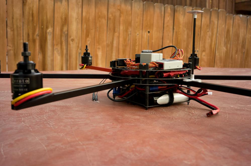

As you can see be my photos this is kinda of a custom build with the MK, I used 3 center plates for the build. My Maytech esc's are all on one level, then on top if the WKM stuff...
Any other advice....?
Oh year I forgot on this build what props would be recommended right now I have APC 11X4.7 would these work? Or do I need to go bigger?
-Steve

AIRCONROB
Hi Steve, I see you're on same par as me on "custom" build, very neat.
The GPS I have mounted the same on M4 which I am told thats ok, and I've used the medium stick, and the IMU settings i have left at zero as it is bang on centre.
As goes for the prop size that depends on how many cells you are going to be running on. Also what is the size between motor to motor?
Cheers
Rob

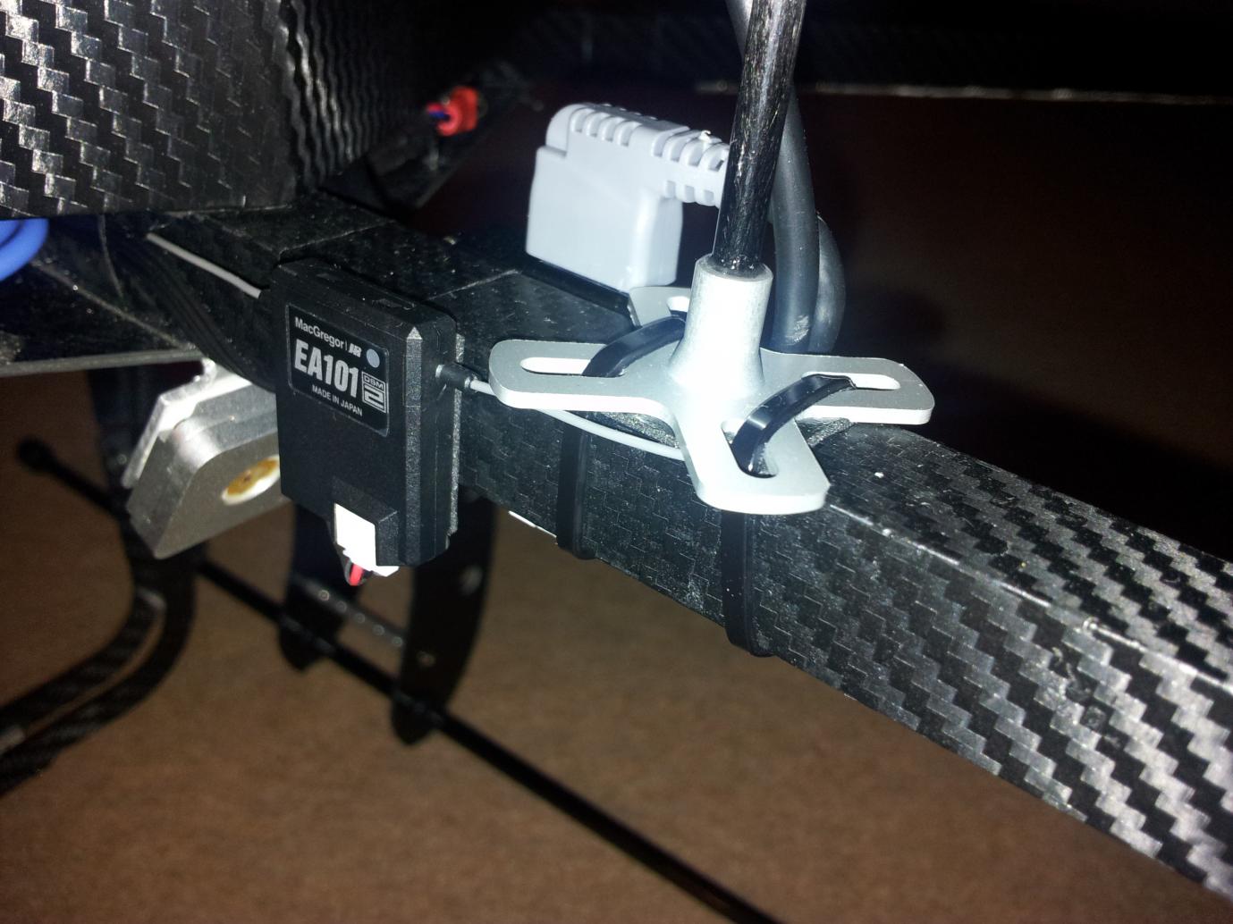

AIRCONROB
Yes I have used 3M pad and a couple os cable ties. And the motors are those the Avroto 2814 Short Shaft?

Do you think I need to do something with the motor wires coming out of the riggers?
I tried to install the wires in the riggers as described in the manual, but the wires form the Avrotors are to thick to go through the existing wholes in the riggers.
gadgetkeith
likes gadgets
looks ok if you mean the first inch from the motors
ive looked at lots of other peoples builds and must admit looks nice and clean running wires inside booms etc
i just keep thinking about the entry point is so vunerable in case of a crash unless you can fit a cap or wire guard of some sort
but it seems thats how its done
have not built one yet so not realy the one to ask but looks good and clean

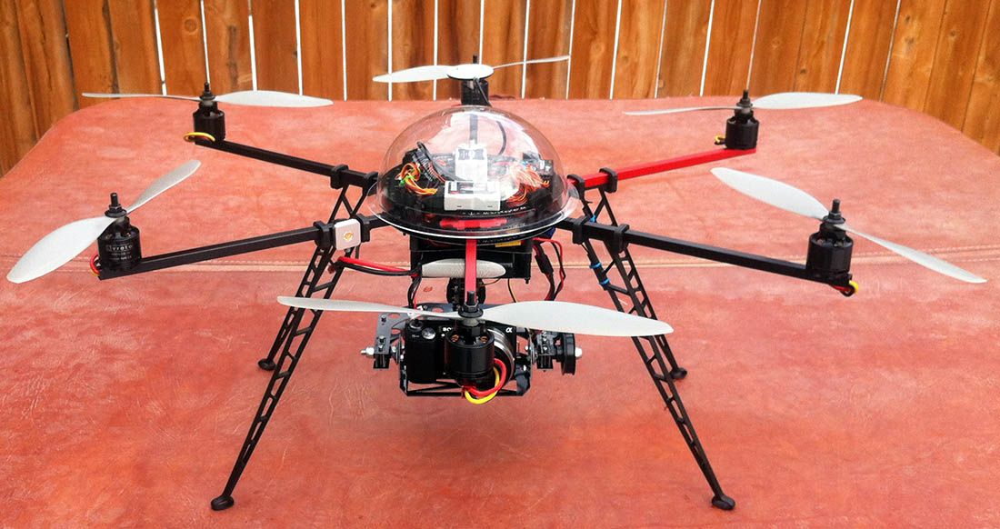

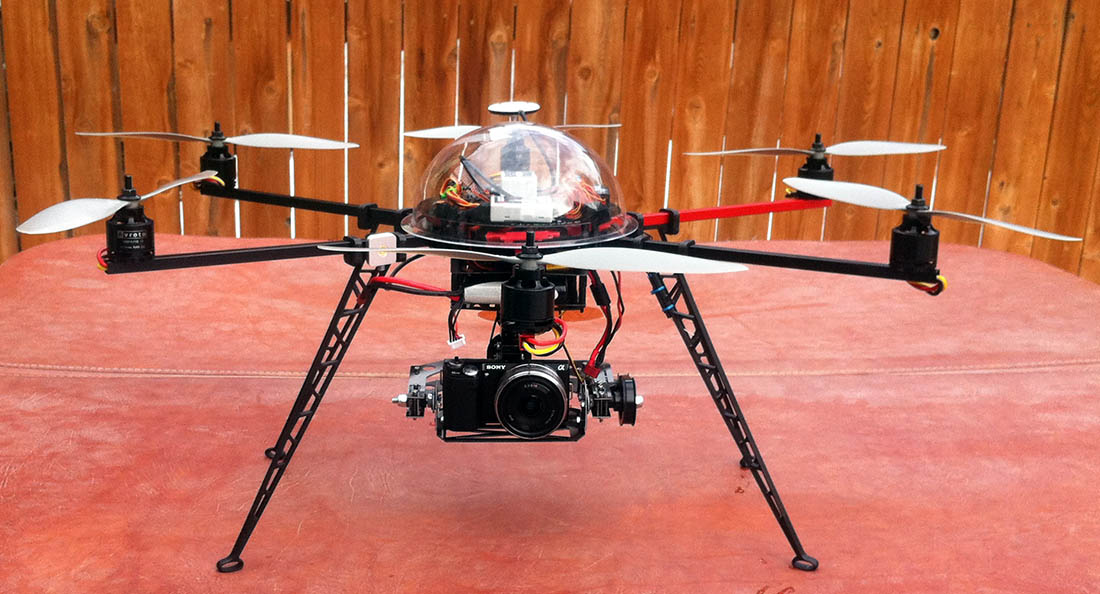

Build done...
Here is my completed build with averticalview camera gimbal.
Test flown a few times now, Still have some wobble though.
I have some new Graupner E-Prop 11x5 on the way to replace my 11x4.7 APC SF, base on RTryder (Ken) advice.
I have my gains turned up a lot 300%
Steven
