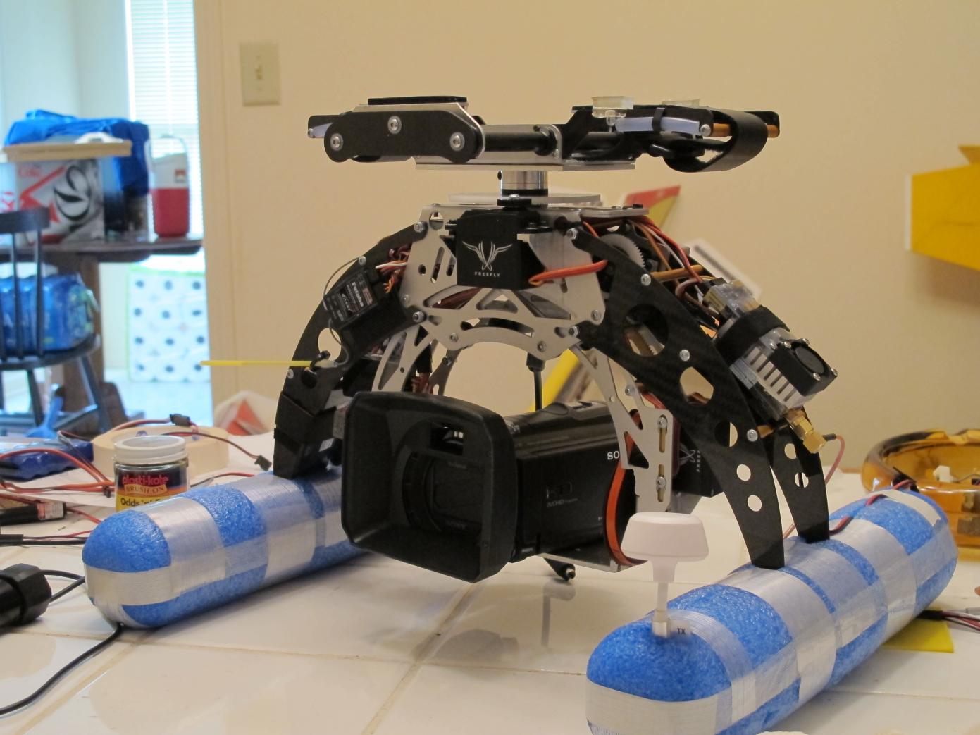

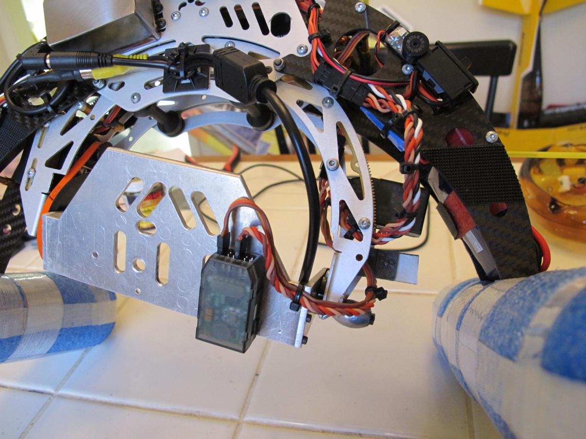

FOX222
The FreeFly Radians and FF360 servos on all 3 axis makes this mount almost tolerable. I also changed the gear ratio on all 3 axis to 5:1 (pan really needs this). I also replaced the tilt tray that the camera sits on as the aluminum foil version that comes with it is crap. One other thing that really helped is to stiffen up the mounting connection between the MK and the AV130 because the whole mount would swing around using the original config.
View attachment 9048View attachment 9049View attachment 9050

JoshMaxAmps
Having the upgraded servos can definitely make a world of difference. Especially over time and servos get that slip they do from use. I just upgraded to a water Proof Hitec Servo. Different field but same idea.

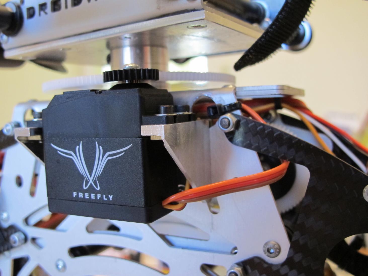

Sorry it took so long to reply. Work has been crazzzzy!
I have done a lot of mods to the PH gimbal to get it to where it is even usable. But to answer you questions...
1) You can change the servo gear with one of these. http://www.servocity.com/html/48_pitch_futaba_servo_gears.html I used 30 tooth along with the 150 tooth stock spur.
2) I made the bulkhead style servo mounts on a Sherline mill but I think you can buy them somewhere.
3)I am not sure if you are referring to the FF servo or the Radian but I had no problem with either.
John

tombrown1
No problem. I'm just excited that there is somebody else who has performed these mods!
Did you need to drill holes into the av130 to mount your ff pan servo?
I did a lot of searching online for mounts and didn't find anything that seemed to suit my needs. I'll keep looking though.
Thanks again for the help and pictures.
