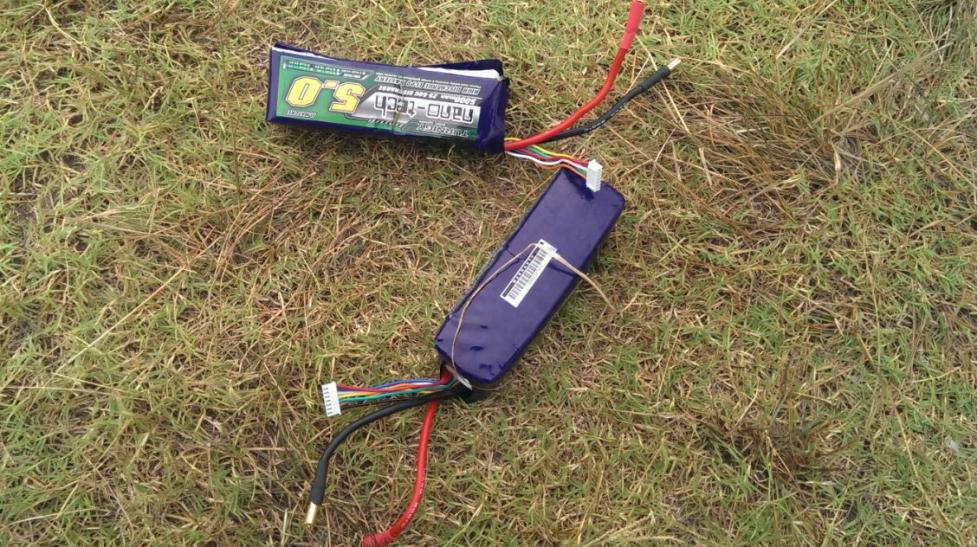

Falling from a height of 557m and off motor output by WKM. :<
yanher

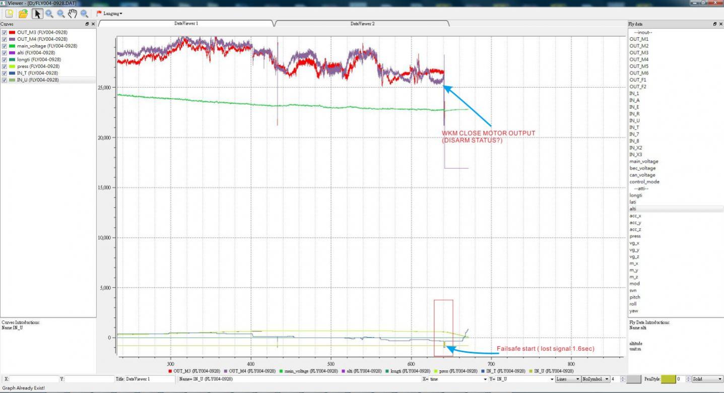

soler
The video does not really show what happened as it stops recording before the failure, for the logs I see that your throttle went to -1,000 or zero % for 2.5 seconds before the loss of altitude.
At time 640, the throttle channel goes to -1000, at the same time the output to the motor spikes for 0.5 of a second and then all motors shut down, I suspect that there could have been a problem with your fail safe settings. Had you previously tested fail safe and loss of transmitter signal?
yanher
At time 640, FC got failsafe signal and throttle channel to -1000 , after FC shut down all motor output. then 1.6sec the signal back but motor can't restart.( I guess WKM into disarm mode) .This is point of this crash.
This is motor stop info on WKM manual.
If you choose the Immediately Mode, you SHOULD NOT pull throttle stick under 10% during
flight, because it will stop motors. If you do it accidentally, you should push the throttle stick over
10% in 5s to re-start motors
I have tested many times for failsafe setting. Wkm is ok into failsafe mode.
you're in the US right? what were you doing at 557 meters (1830 ft)??
yanher

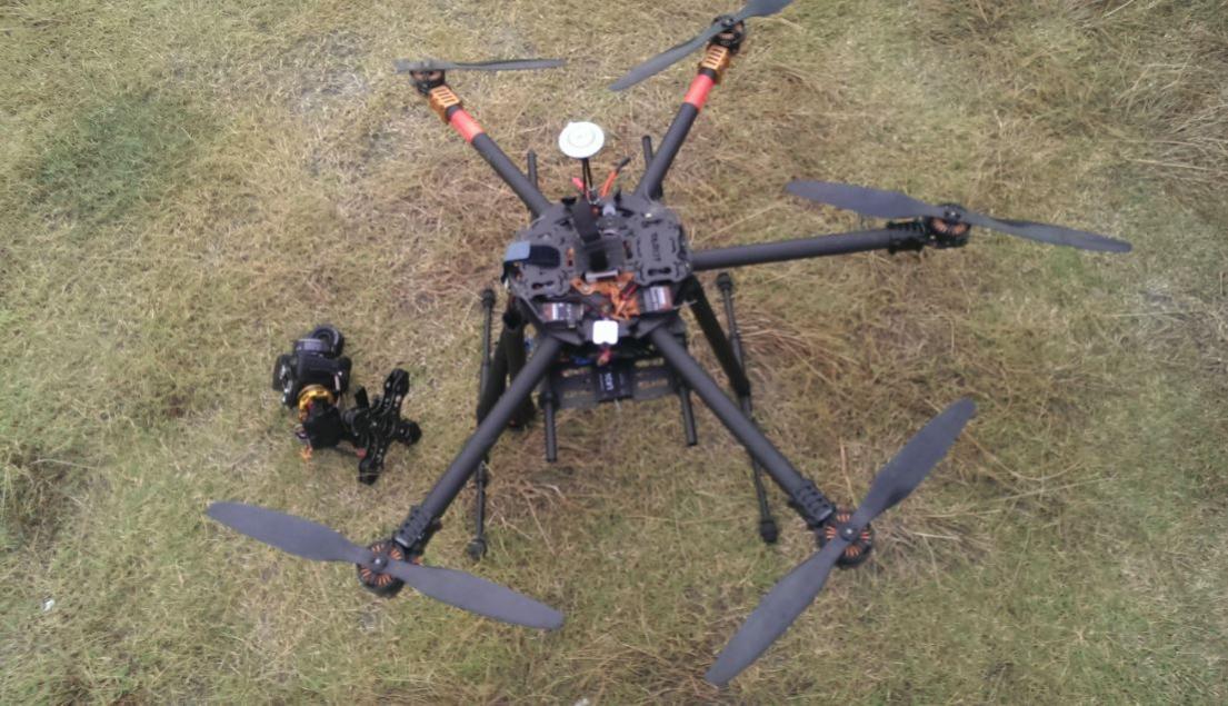

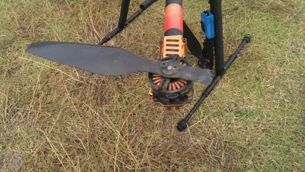

I'm in Taiwan. video shot for fireworks and night scene of city.
In this time I have two flight shooting. Unfortunately, crash in the second flight.:upset:
Vehicles falling in the forest. Luckily found vehicle on next day morning.

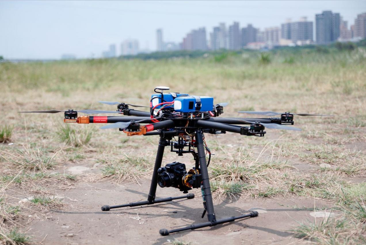

yanher
How much flight time do you normally get? Video cuts out at nearly ten minutes, getting to that altitude might have burned extra power. I don't know how to read the log so maybe this theory is dispelled. Also how long have you been flying?
5000mah 6s * 1 for 8~9mins (older lipo) , 11mins (new lipo)
5000mah 6s * 2 for 16mins+ (older lipo) , 19mins (new lipo)
T810 hexacopter
WKM + IOSD2 + 2.4ghz ground tx
W4822 kv390 + 1555 DJI like carbin propellers
Hobbywing 30A ESC
2AXIS Brushless gimbal
Sony 520 line CCD (0 Lux for night flight)
GH2 + X14-42mm
HDMI to AV
Aomway 1000mW 5.8g TX
12V BEC for Gimbal , 5.8g TX .

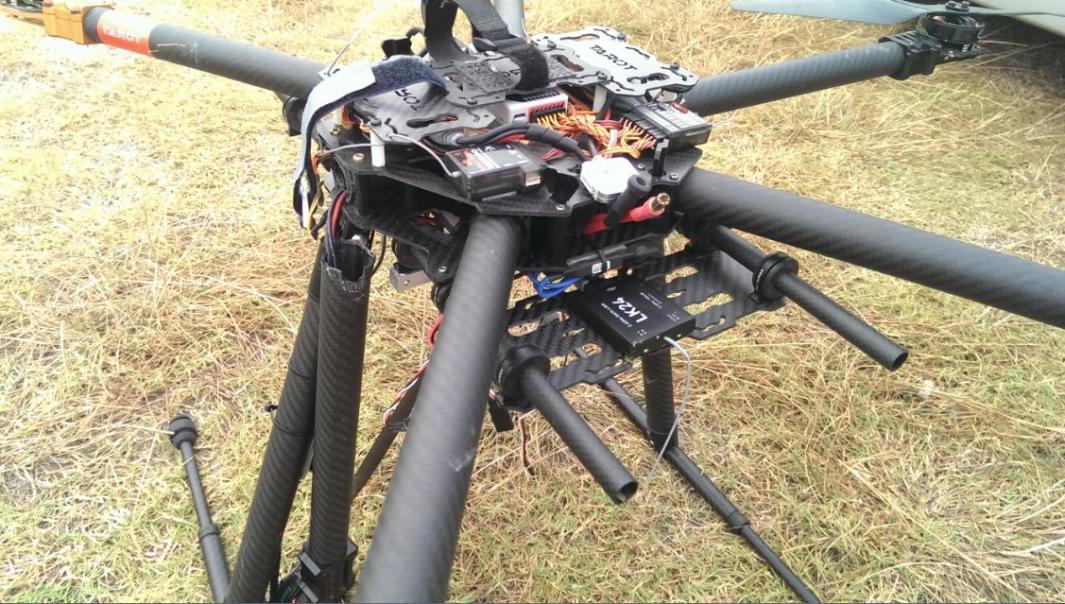

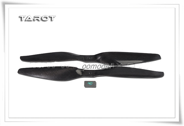

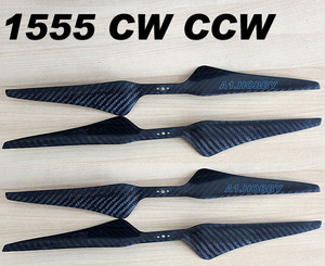

Propeller types affect flight time.
in my tested, (old lipo)
1470 carbon propellers for 6mins for 1 lipo
1555 carbon propellers for 6.5mins for 1 lipo
1555 carbon propellers (DJI like) for 8mins+ for 1 lipo
Ok, I was referring to my 5800 mAh / 4s batteries, not 6s.
However, I'm still impressed by the flight times. How heavy is the MR, incl. payload?
How do you manage to almost double the flight time with 2 batteries instead of one, my personal experience is maybe factor 1.5-1.6 at best.
  • Tarot-1555-font-b-Propeller-b-font-TL2831-T-Series-Efficient-font-b-Carbon-b-font.jpg
