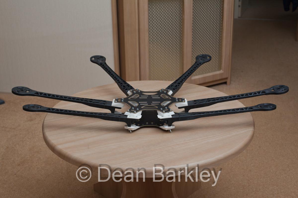

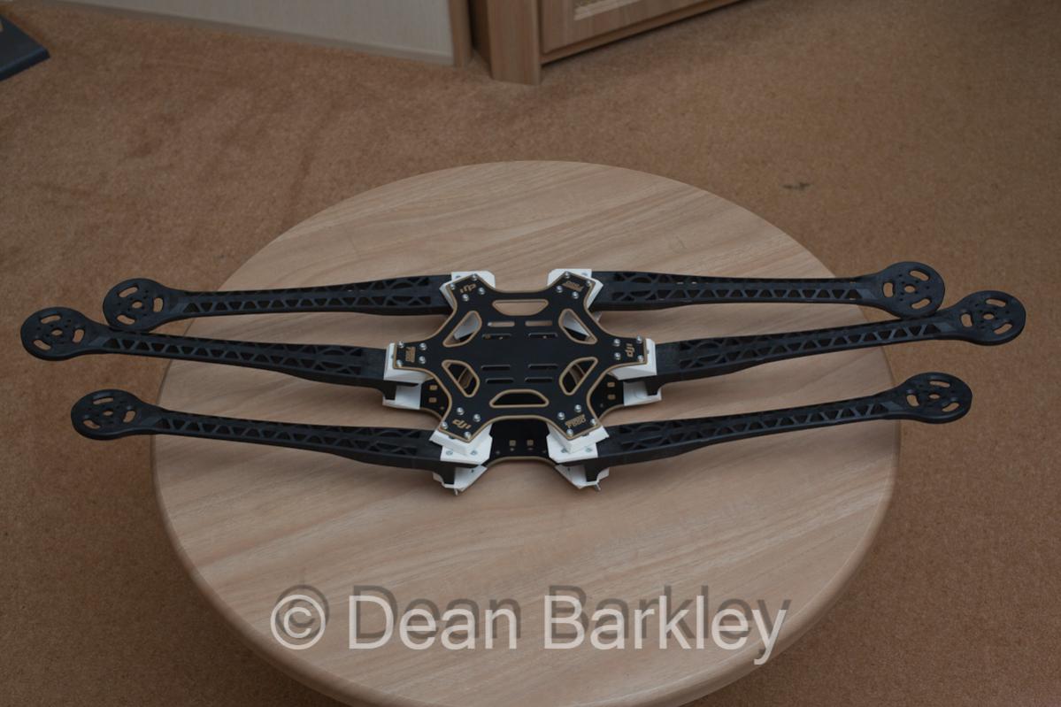

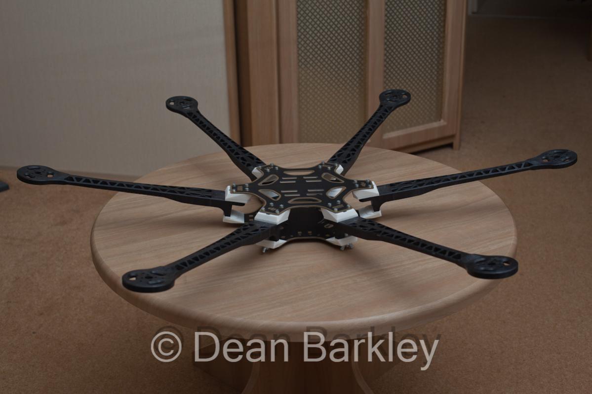

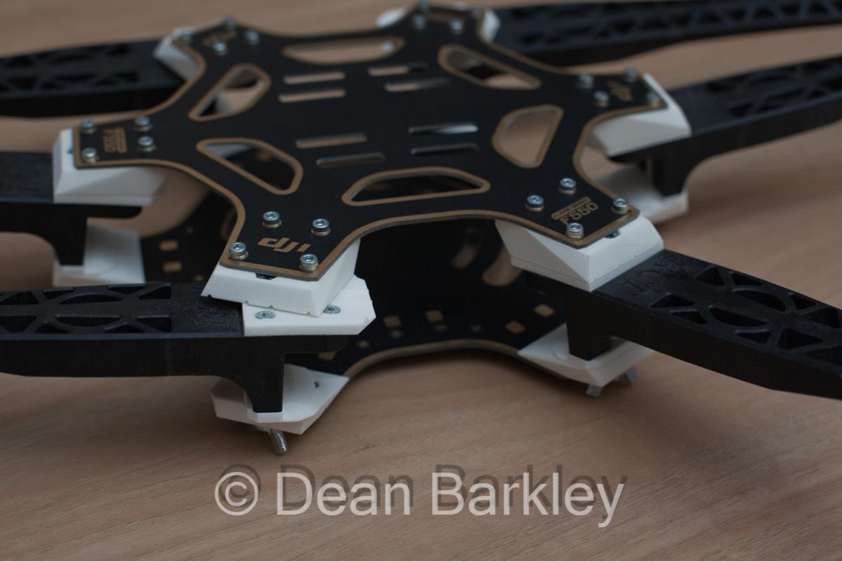

Just thought I would post up my new hexa-build, which uses RCT800 arms on an F550 hub assembly. I've mounted the arms on some custom made mounts that give the arms a 10 degrees dihedral (as the DJI S800), and also foldable for ease of transportation. At the moment the arms lock into place by tightening wing nuts but I would rather have a quick release mechanism such as you find on cycle wheel hubs. If you have any other bright ideas I'd like to hear from you!
Here's a few photos of my new hexa.....
