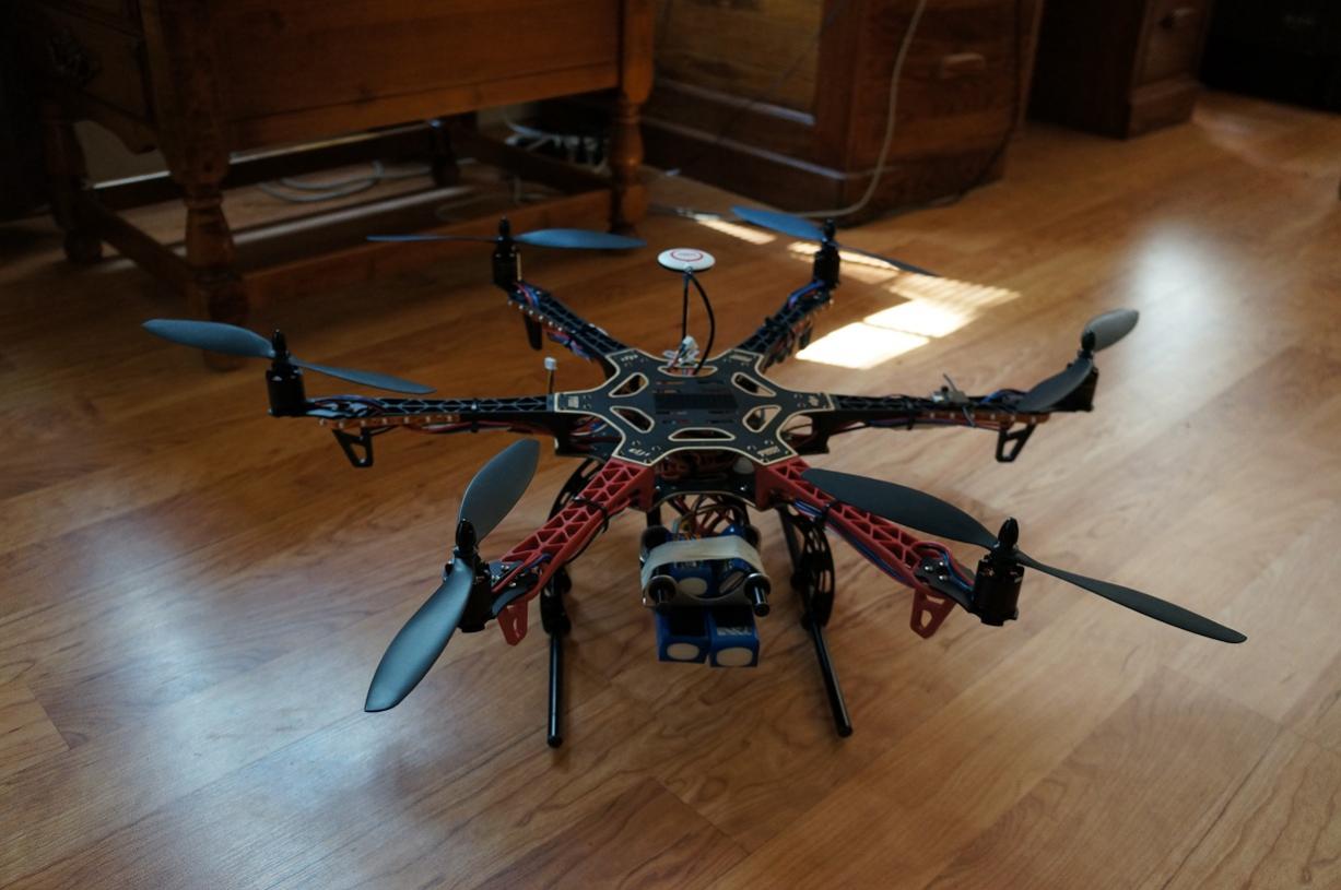

Here is the progress I made on my F550. Re-soldered and replaced the bottom plate after a crash. Just finished getting everything back together, it's looking so good!
I also have aerial media pro's arm extensions, 11" props, and aeroxcraft landing gear to try out later.
