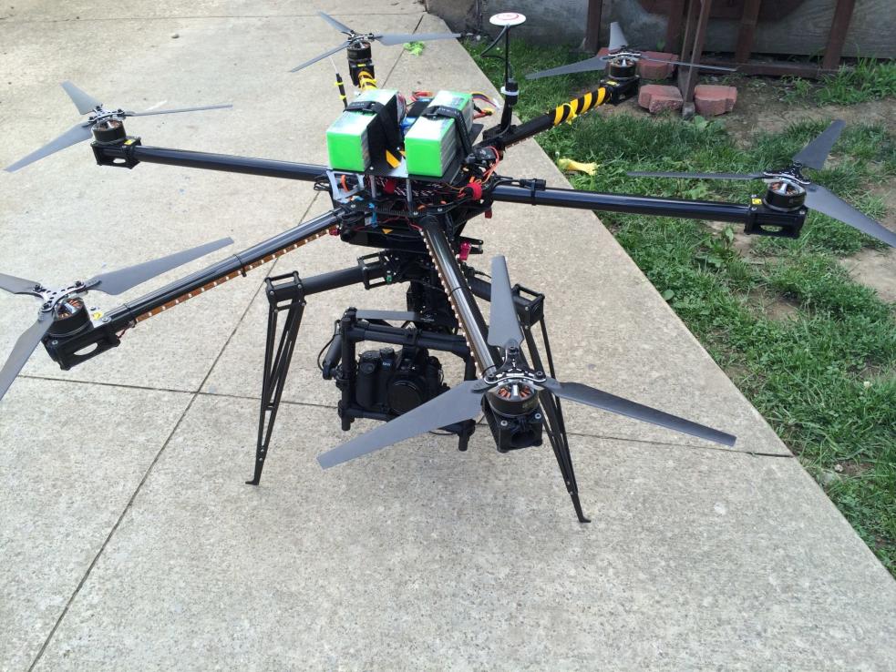

Folding props (good quality ones) ROCK.
They actually cause WAY less vibration than normal props. Especially the 3 bladed ones.
They take just a few minutes to balance, and the tiny hit in efficiency you take I think is worth it.
To balance you simply weigh each blade and match them to the lightest. Most of the DJI 15/5 blades were spot on for me.
Transport is easier, and the cost is a LOT less.
