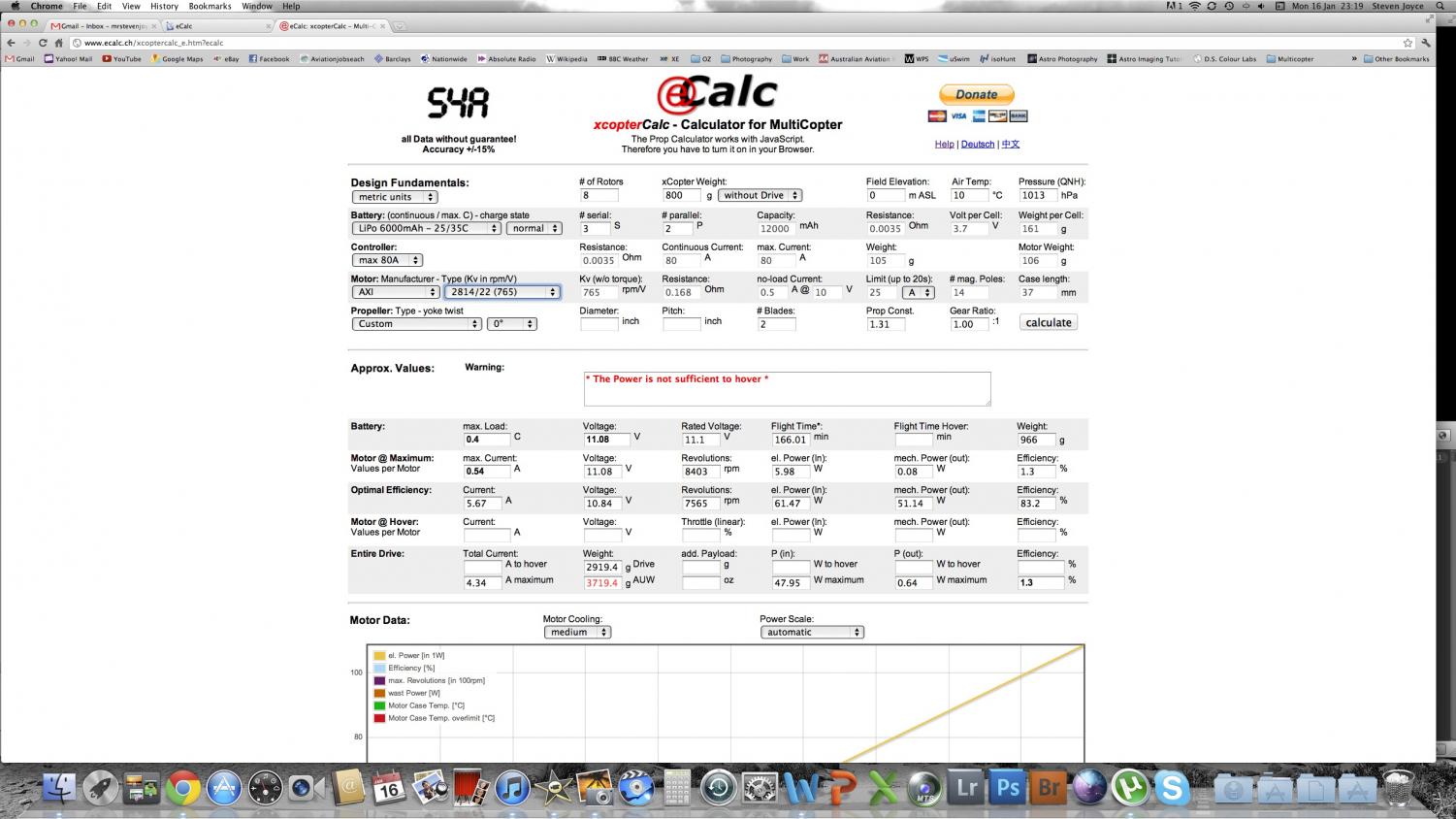

Can someone explain the eCalc to me. No matter what I put in it states that " * The Power is not sufficient to hover * "
I'm trying to figure out what to buy for my Droidworx AD8 HLE.
Orracle
Could you post a screenshot of what you have selected so far in eCalc to give you that error message? It will be easier to help you from there.

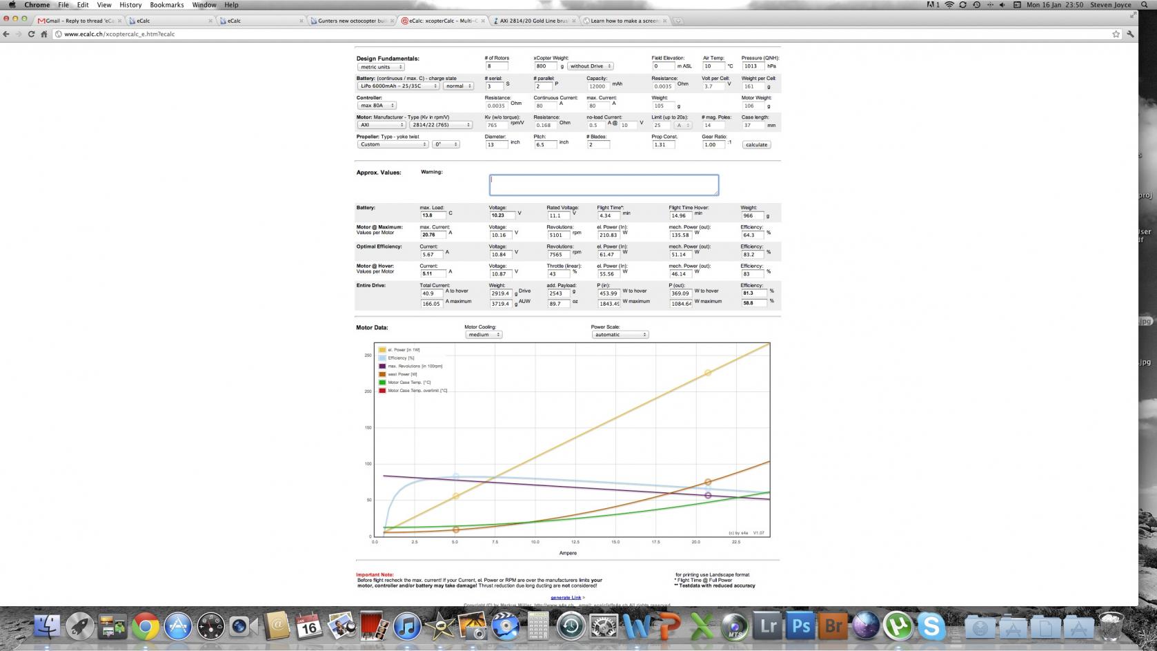

homer911
Hi,
Below is the screen shot of what I have put in already. Its the first time I have used this so it could be something basic.
Steven
homer911
Hi,
Thanks for that. I had to change the battery to 3S and change props to 13 X 6.5. Thanks. Does this mean I cannot use 4S batteries, or I will just have to re configure?
