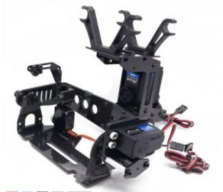

I don't know the current weight of my craft, but it's getting heavy. Original f450 frame with ESCs and Naza + GPS, but I've added an Arris CM2000 Gimbal with GoPro, and I typically fly with a 3S 4000 - 4500 Mah battery. I plan to add to all that some FPV equipment (FPV camera + Tx). (Attaching picture for reference.) So I'm wondering if anyone has recommendations on any of the three above? There is a significant jump in weight to the 2814 but I'm wondering if that may be ok given what I have on my craft. Though these all have a lower kv rating than my current motors, will they be more efficient or suck more power? In addition, what is the -16,-12,-10 mean with respect to the motor's capabilities?

Just bumping this to see if anyone has advice? I'm leaning towards the more powerful motors (2216 or 2814) but want to get perspectives from anyone first. I know the 2814's are heavier than the other two but given the weight of my machine I'd like to have the most efficient motors. Max flight time is the key idea, not necessarily speed or power. '
