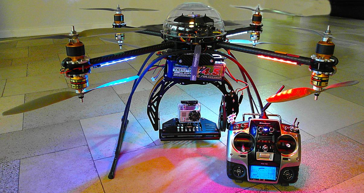

I just switched my DJI 8" props on my F550 hexa to 8" Graupners. I used a step drill to make the hole 8mm. Just an FYI, the top hole is 5mm and the bottom is a shade less that 8mm. I set the drill press to stop at the top of the 8mm step. When I mounted the props, they were very tight. However, the mounting nuts were sufficient to make them flush with the bottom of the DJI motor mount. I like this in that they are flush and centered with the original Graupner moulded hole. I flew it this evening in a 10x10 area between two buildings with winds at 20mph and gusts. At times the hexa was tilted over 10 degrees to fight the wind. It was fun in a weird sort of way to try and get it to hover in such a small area. I will say that the Graupners were more efficient that the DJI props. I got an extra 2 mins before the second level of the battery monitor kicked in. That would give me about 20% more flying time or about 10mins. I am happy with that. I will reserve full endorsement until I can at least test them within the parameters specified by DJI, i.e., 17mph.
P.S. The 1/3 hp drill press with keyless chuck was $80 at Harbor Freight and the step drill was $13.

just recieved my new graupner 8x5 verry smooth flying on my quad. But how do i secure these props best on the standard dji motors? I drilled them to 8mm so the fit the shaft ok. But the normal dji prop are locked beceause they get stuck on the shaft. For now I just realy titened the prop nut. How do you other people do this with the graupner props?
