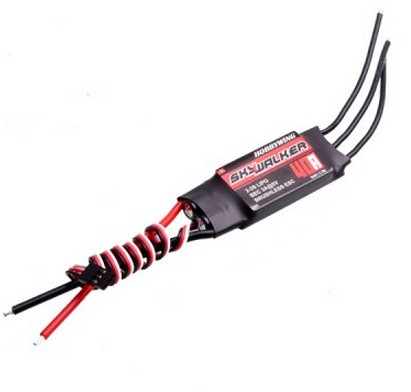

This an typical Brushless ESC, the red(+) and the black(-) (on the same side)are wired to the power source, the black-red-white one plugged into a receiver, am I right?
Or, could you show me the ESC you've talked about? Thank you...
