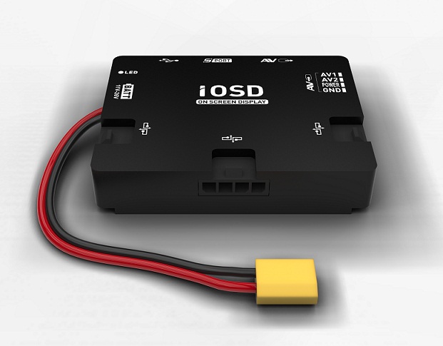

DJI On Screen Display (IOSD) with 2 AV-in,releasing soon.

nice, but do have a few observations…
can the osd be usd as a hub as i have no spare bus connections when using the 2.4 data link?
for use as an fpv osd it would help to have 'distance from home' and 'direction/pointer to home' info.
would also be nice to have a receiver (ezuhf for example) rssi input so that could be displayed too.
i assume this will work with third party VTx's

Well it looks like it can be used as a Can-Bus hub, it has 3 ports.
I have just had a read of the manual, and distance from home and direction to home is all there,
no RSSI though.
Manual should be attached, I think :)

that connector looks like the old school tamiya power plugs from back in the day, that is a mess.

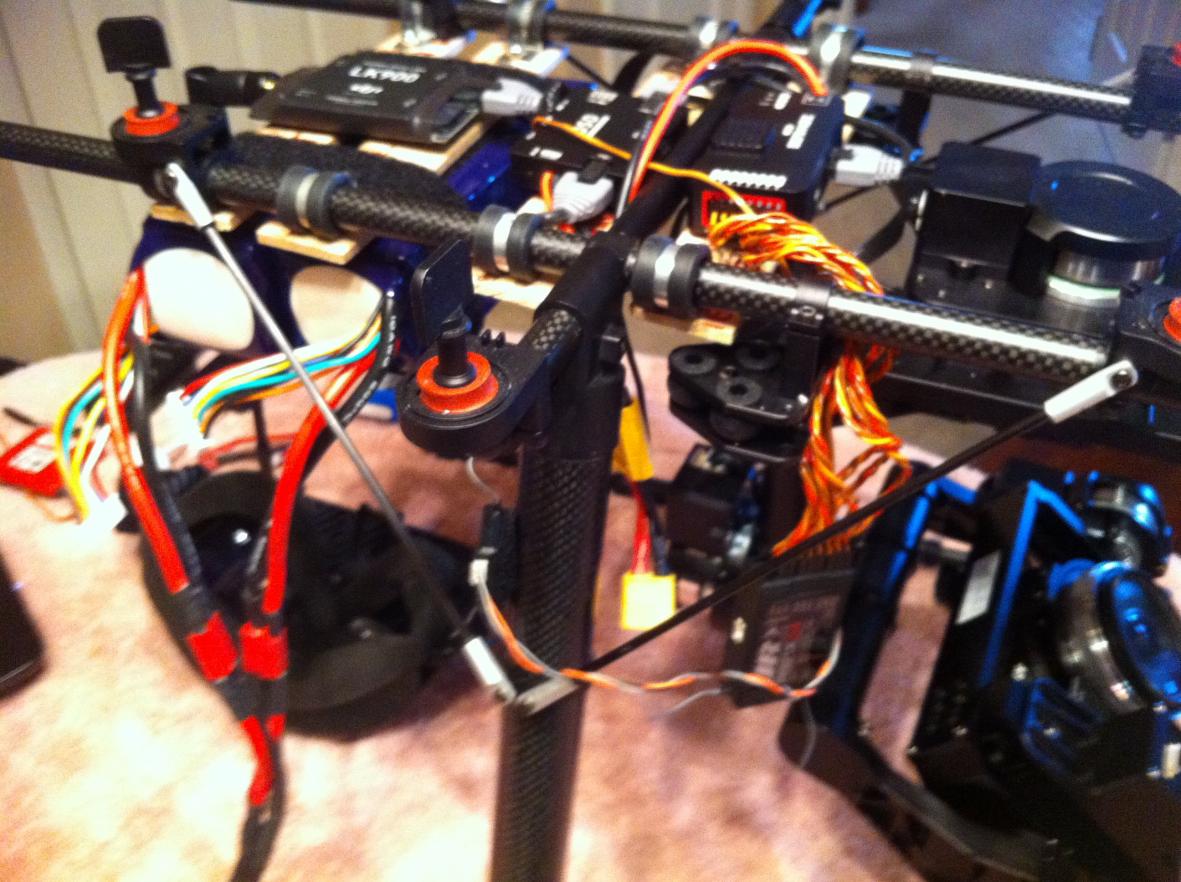

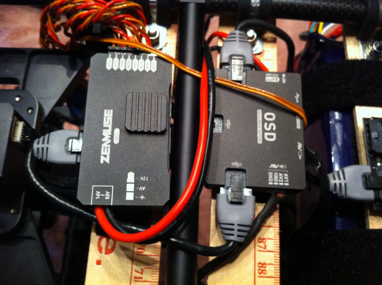

Mine just arrived and after a quick set up I hooked up my video goggles for a quick test. I got the OSD display but no video from my Nex5N. I checked all the connections and after several frustrating hours discovered the connector from the Z15 to the iOSD had the leads reversed. The ground was where the video was supposed to be and visa versa. After I corrected that everything was fine.

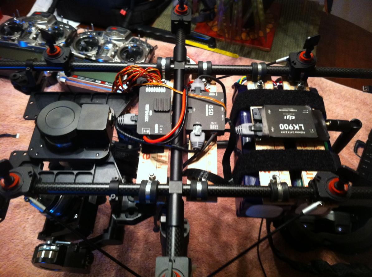

The set up was quite simple. If you are using a Z15 there is a plug that goes from the Z15 video out to a six pin port on the iOSD. If not, the iOSD just connects to the can bus. The iOSD is switchable between two video sources, V1 & V2. To do this you will need a free 3-position switch. Mine came with the necessary leads to be able to construct a custom cable do this which is a nice feature. If you are using the DJI Video Down Link there is an 8 pin lead that connects to the vTx, if not they supply a connector that will allow you to make your own connection to your vTx. Another nice feature is that if you are using the 2.4gHz Data Link you get 3 can bus connectors on the iOSD. I have the 900mHz which has 2 but the 2.4gHz only has one. Now those users will be able to connect everything.
If you have seen the screen shots of the iOSD or the Ruling the unit that I received was just like them. There is plenty of information displayed. Artificial horizon, height, distance from home, number of satellites, voltage, voltage warning level, video channel, video input, orientation from home point, velocity in m/sec, pitch attitude and roll attitude in degrees, control mode and failsafe mode. The graphics are pretty simple right now but the iOSD has a mini usb port for future updates.

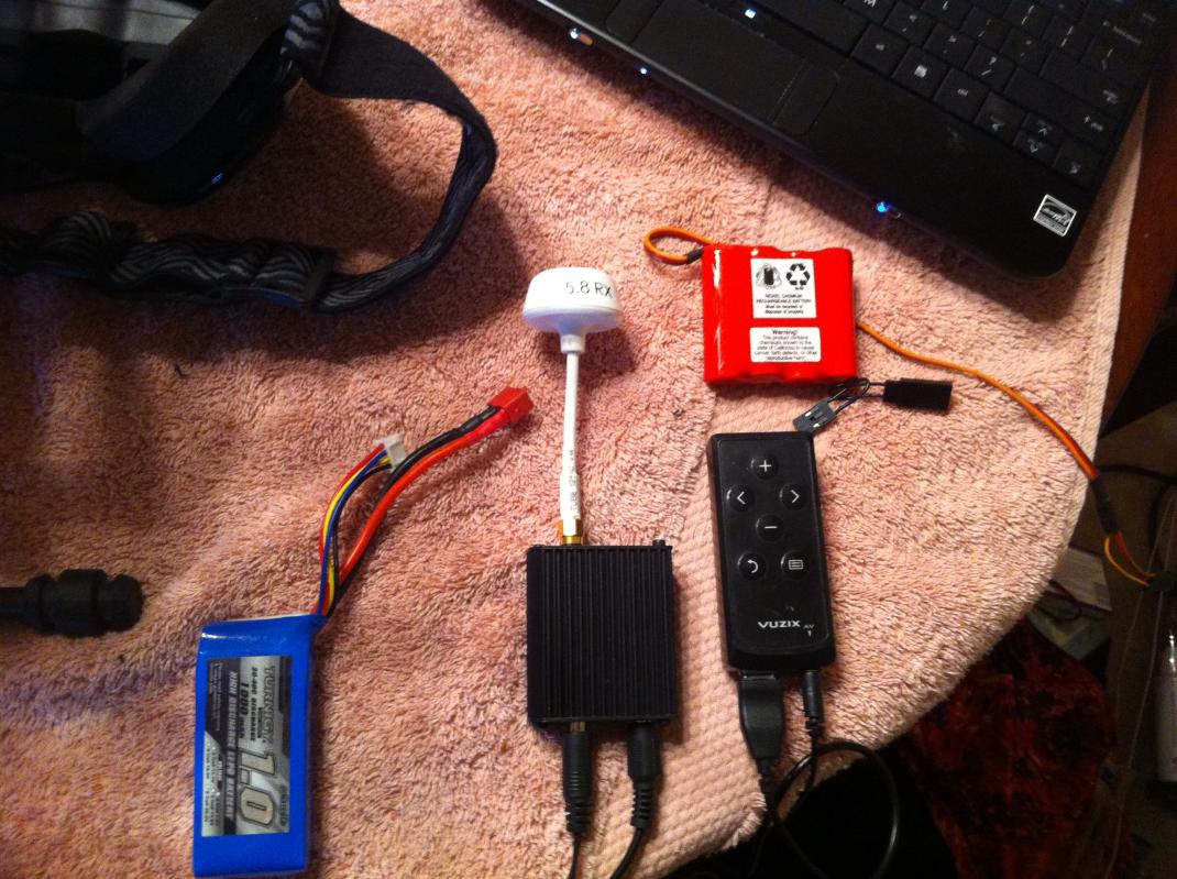

A few notes about the vTx/vRx combo. It is a 5.8gHz 500mw unit with a cooling fan. You change the channels on the vTx using a three position switch on your RC Tx, the same one that you use to change the video source. The vRx has a button to access the 8 channels. I do not have a 14ch RC Tx only a 9ch, so I ended up using 2 R921's and 2 JR9503's, one for RC control and one for Gimbal control. I am using a total of 16 channels to control all of the functions of the WKM and the Z15 with iOSD. The new 18 ch Dx is starting to look pretty good if you want to attempt a single operator version. I would not attempt it for anything other than the simplest of jobs.
The vTx/vRx frequencies are compatible with Foxtech but not Immersion/FatShark. I think this is unfortunate and I would like to see them offer both versions. I have a diversity ground station that now needs another vRx. Mine came with the optional antennas. These are very cool units with the CP antennas enclosed in a plastic housing. They should be very durable. They look very similar to these: http://hobbywireless.com/index.php?m...roducts_id=821. If you decide to get the Video Down Link, I would recommend getting the optional antennas or an equivalent antenna. I have switched all my FPV multi's to CP antennas and I am very happy with the result.

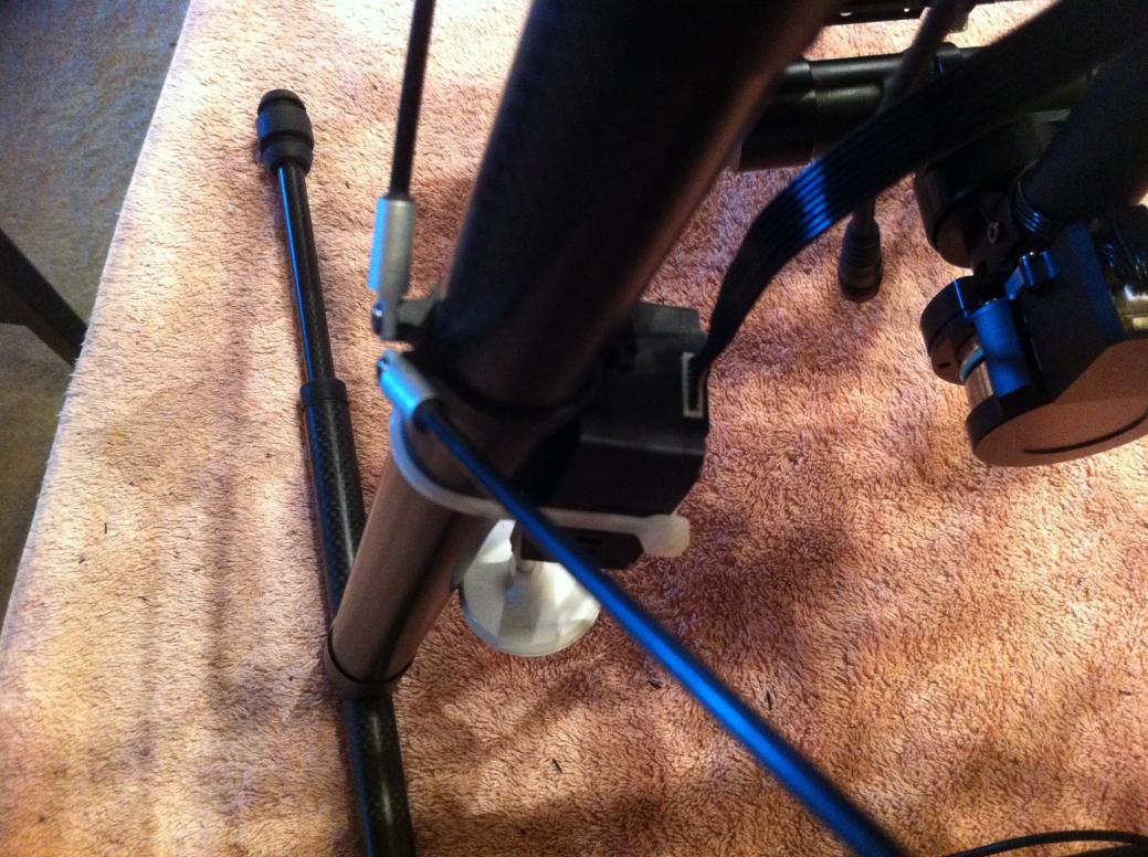

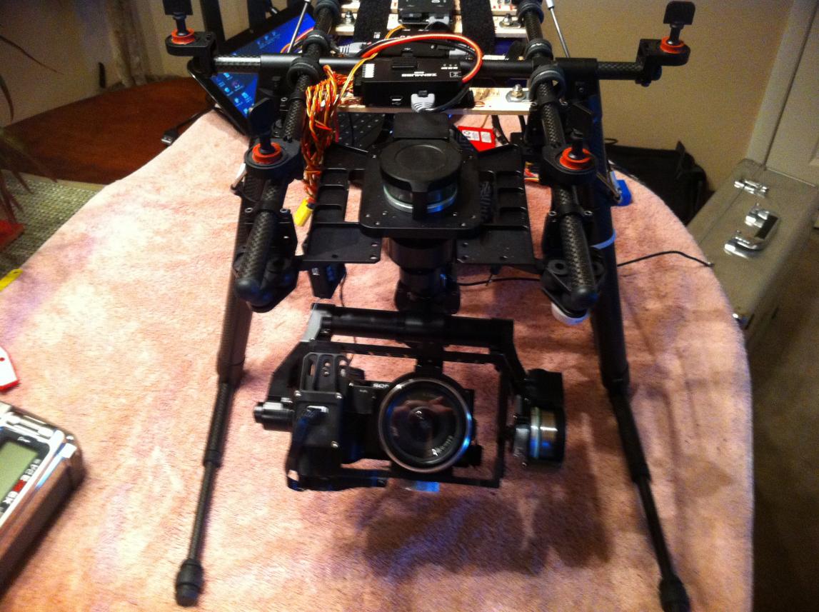

Since I am still using my temporary battery mount, Ace Hardware yardstick and 1/4" plpe clamps, I decided to keep it simple and made two more, one to mount the GMU and the other for the iOSD. Yes it is ghetto but it works and the pine in the yardstick is lighter than CF. I will probably do something different in the future, but it works for now. I have attached some pictures of my set up for reference.
