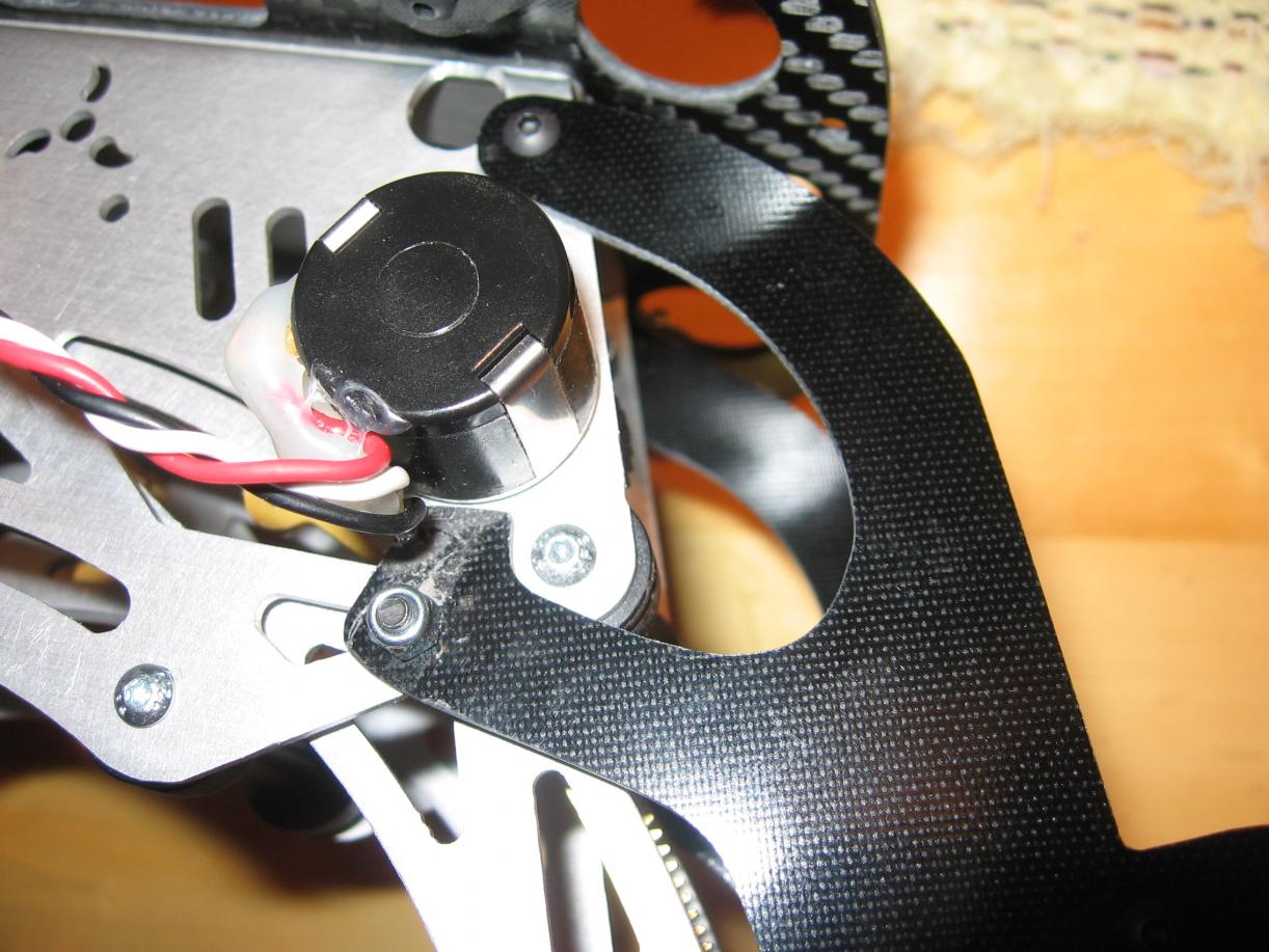

I ended up attaching an arm from my hobbyking talon frame out the back and mounting the GPS, to be away from everything.
GPS worked perfect, Return to Home worked perfect ... then only recently I've been noticing the TBE.
So, like ya would, you move it as recommended and its perfect again.
My quesiton is ... why? does the GPS go bad?
For it to work perfect, then all of a sudden turn into this Toilet Bowl Effect, shouldn't be.
Having the cable stick out that tube, then be off-centered, annoys the @#$% outta me the most.
