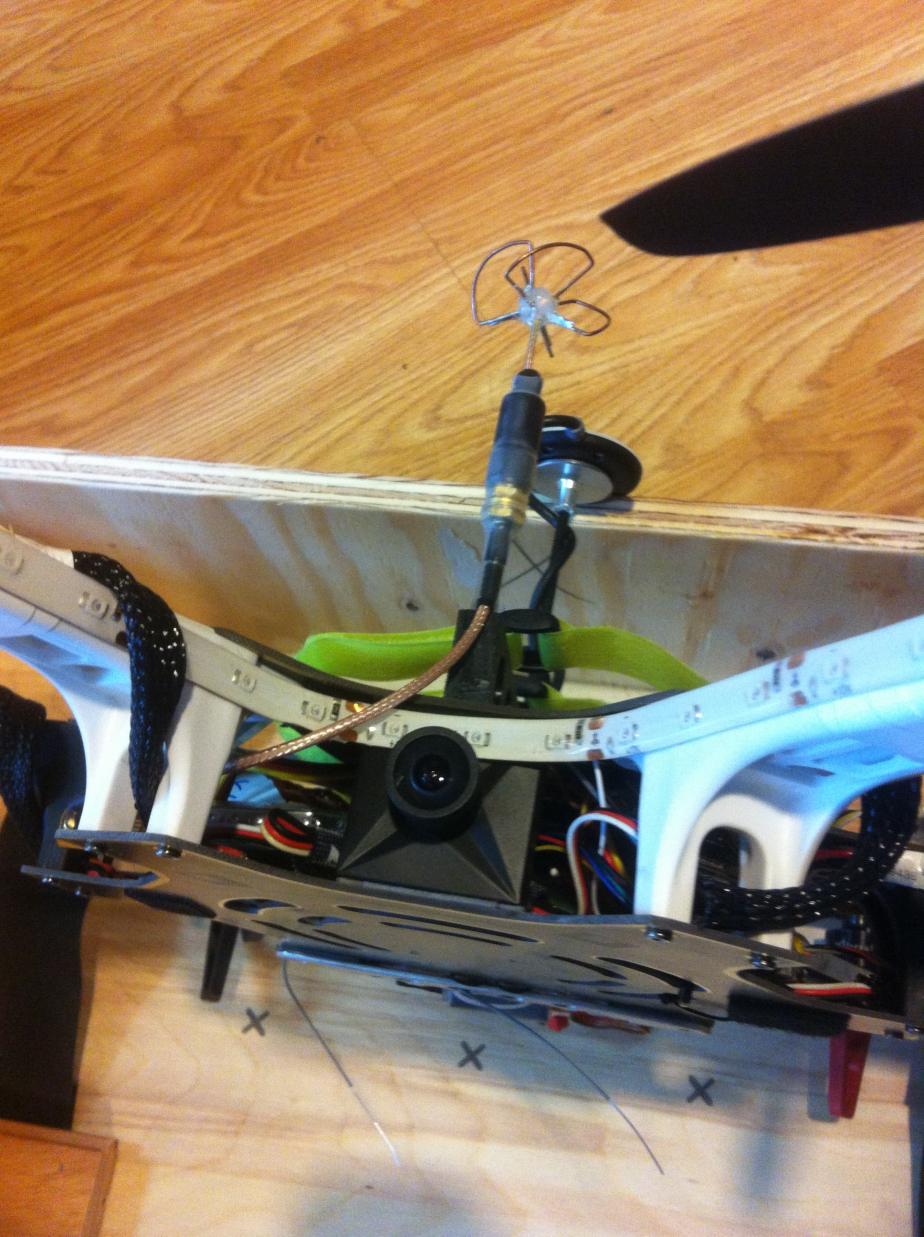

I am all set to maiden my new build but having some issues with DJI's Naza Flight Controller. Here are some rough specs:
Carbon Core 950
Spektrum AR8000 Receiver
DJI Naza GPS
4 x 5800 6s 30c Zippy Batteries (2 on board)
6 x 480kv Turnigy Multistar Motors
6 x 45 AMP Turnigy Multistar ESC's
6 x 15x5.5 CF Balanced / Matched Props
PhotoshipOne 3X Pro v2
PhotoshipOne 3X Pro / Carbon Core 950 Mounting Plate
2x Spektrum DX7s Radios (Gimbal / Heli)
1 DX7s Telemetry Unit (Pilot)
The issue is that the copter idles super high regardless of all settings in Naza. Radio settings are clean, I have the throttle travel control to 150% and can see full range of motion in the Naza Assistant.
