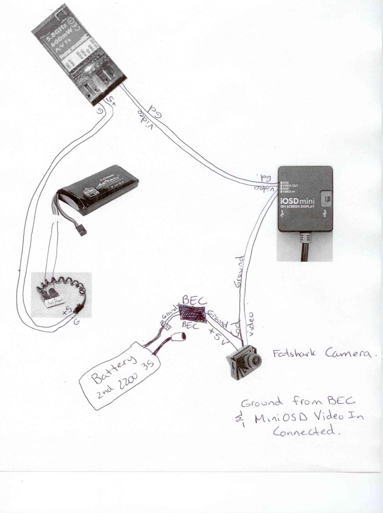

Ive setup my Hex with the new DJI MiniOSD Im concerned whether Ive grounded everything correctly or created a ground loop.can someone please look at my setup.My concern is with the DJI Miniosd grounding together with the ground from the BEC at the camera.I didnt know where else to ground it.Thanks any help appreciated.Ive read up on ground loops but cant seem to make head or tails of it.
