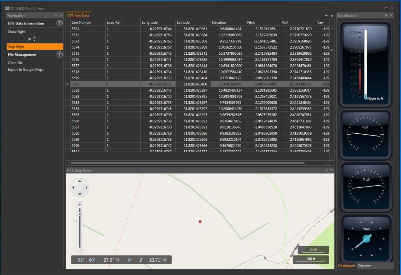

I've spent a couple of days creating an application to use the DJI iOSD Data.. This is not fully alpha tested yet.. But if you are interested in a copy in a week or so PM me and I'll send you the link.. Free of course... (at the moment LOL)
If interested will show how you load the data in and get the information..

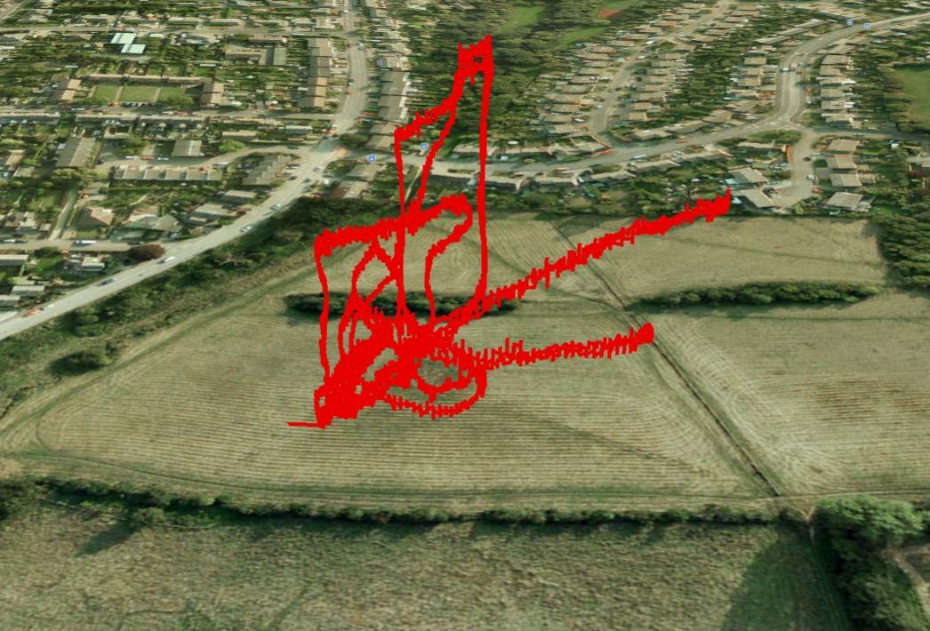

This will show you at a click where you was flying, GPS Coordinates as well as Altitude, yaw, pitch and roll. It will fly you through your data showing on the map you location and where you were flying.. You can also export this data to Google Maps to see your complete flight path..

Instructions..
1: you need to download the GPS exporter from DJI site http://www.dji-innovations.com/download/wookong-m-waypoint-downloads/
2: copy the files install from https://www.dropbox.com/sh/lvu5et4y8jkof88/KbB_mDdh2C please copy do not drag and drop as this will remove the files from the server.
3: install google earth download from google if not already.
4: use the DJI GPS converter to convert your iOSD dat file into a txt format..
5: drag and drop the file into the black area above the map. Or use the menu file open and select the converted file.
6: click on. Any line in the data and this will point to that location and data select as you wish..
Flight:
Select start flight this will run through your flight showing you in the map below.. If you raise or lower the number on the zoom in the left menu it will zoom in and out.. The flight will continue until it reaches the end or your select stop flight..
Export..
Select export to google maps and save the file on your desktop.. Double click on file and it should open in google earth..
BUG.. I've had some issues but I think it's google earth that when finished google earth doesn't close down correctly only happens now and again.. But if does ie you double click on the file again and nothing happens you need to kill the service in manager on your pc..
Have fun load some examples up and again please it's install at own risk..
