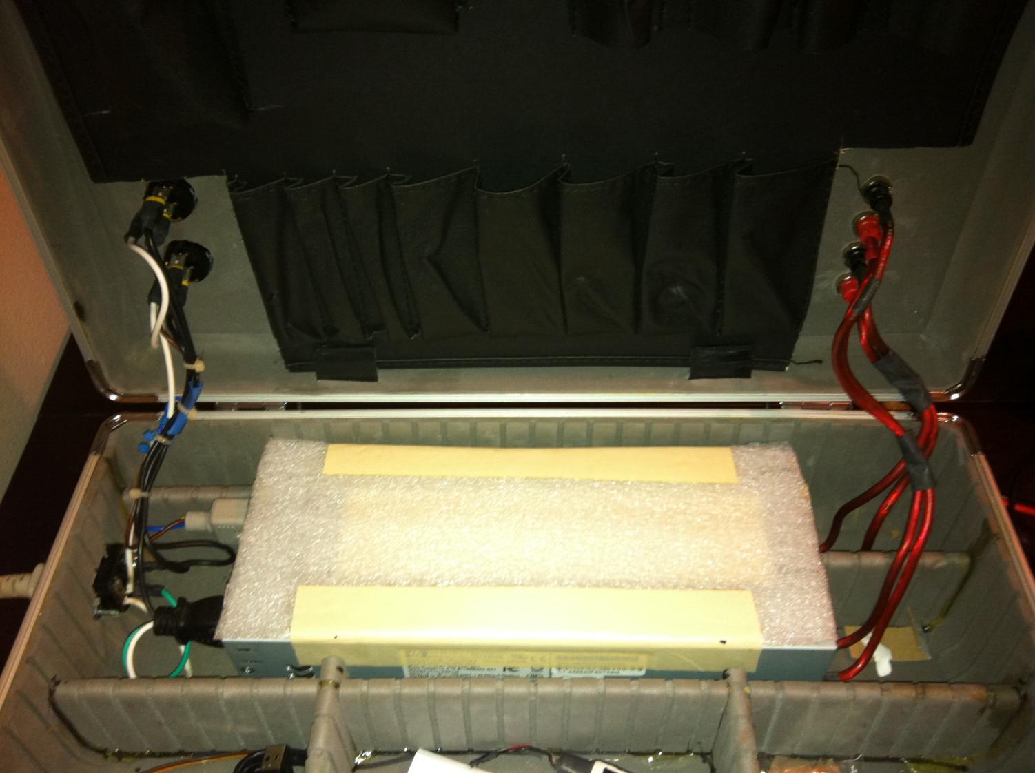

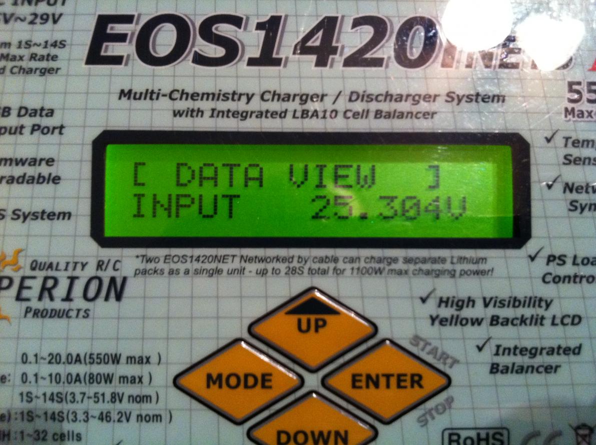

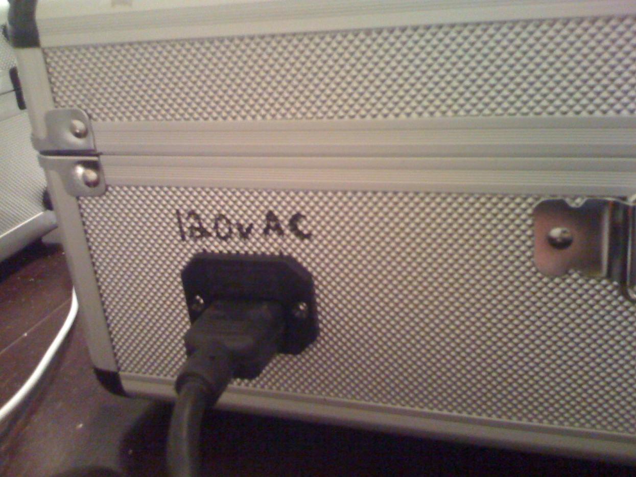

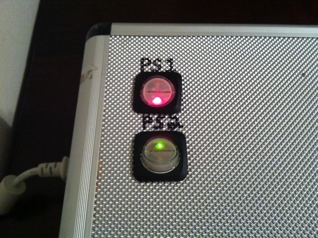

I also have that hex, it flies great! I also have been into large electric helicopters for some time now. I currently am charging with the TP820CD and love it! I use 2 HP 47a server power supplies in series to power the charger and take full advantage of the output wattage. One thing to consider is the chargers max output and what it needs to attain it. The 820 requires you to have 28 volts and over 43a of current before it will output the full 800w. So making sure you have a power supply that will give you the full potential of the charger is important also. The PS you're looking at will not give you great results as it is under powered for the chargers potential, granted you are not charging 5s-8s batteries. I would look at doing a DIY Server Power supply conversion like what I did, It works great and I think I have all of about $75-$100 into my whole power supply system!

I have had a lot of experience with the hyperion chargers, they work great also, they just balance too slow for my liking. The TP and iChargers use a 500mAh balance current. The only other charger that I have used but do not own is a FMA Powerlab. This is a beast of a charger! 40a and 1344watts is great but the main draw back for me is the single output, I'm not a believer in parallel charging, I've tried it and didn't like the end results. So for me the TP820 was the ticket! TP also has a new 1430 charger that will do 14cells at 30a with 1000w of total output power. But like tomstoy2 said "buy it right, buy it once!"
