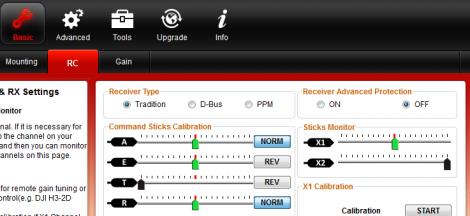

All functions work (Switch E is Manual/Atti/GPS but what I can't get to work is the IOC function ( set to switch C and that is assigned to X2 in the software). When I go to the "Basic - RC" page in the assistant, you can check the workings of all switches and gimbals, and they do work, even the X2 switch moves to the three positions.

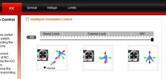

When I then go to "Advanced - IOC" page, I click the checkbox to activate IOC, but when I then flip the switch, nothing happens. When I leave that page, the IOC settings is not being saved and again unchecked when I go to the IOC page again.
All of the youtube video's I saw do have the older version of the software and there's a "write" button, wich I can't find in this new version. By the way, the T8J is setup using all wires, not S-BUS and "traditional" is selected as the transmitter mode.
