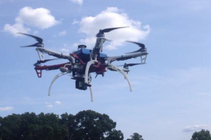

I've done close to 70 flights on my new DJI 550 Hex and the FPV flying has been easy, reliable, and produced great results. My set up is listed below.
The basic flight platform is based on the DJI F550 Flamewheel using the Naza M w GPS V2 flight controller. The propulsion is provided by the 6 set DJI E300 Tune Propulsion System, generating a maximum 600g per motor lift. I use a Futaba Rx and Tx, connected by sbus to the Naza. The drone uses 4S Lipo's from 5000mah to 8000mah. The flight drone flies well at all levels of load from nothing to about 3000g (the most I've lifted). Controll and agility scale with weight, though there is a steep decline after about 2600g. Max Speed is aprox. 35 mph in attitude mode. The build process and drone performance of the drone itself has been excellent. The FPV and AP setup has been more complex and challenging.

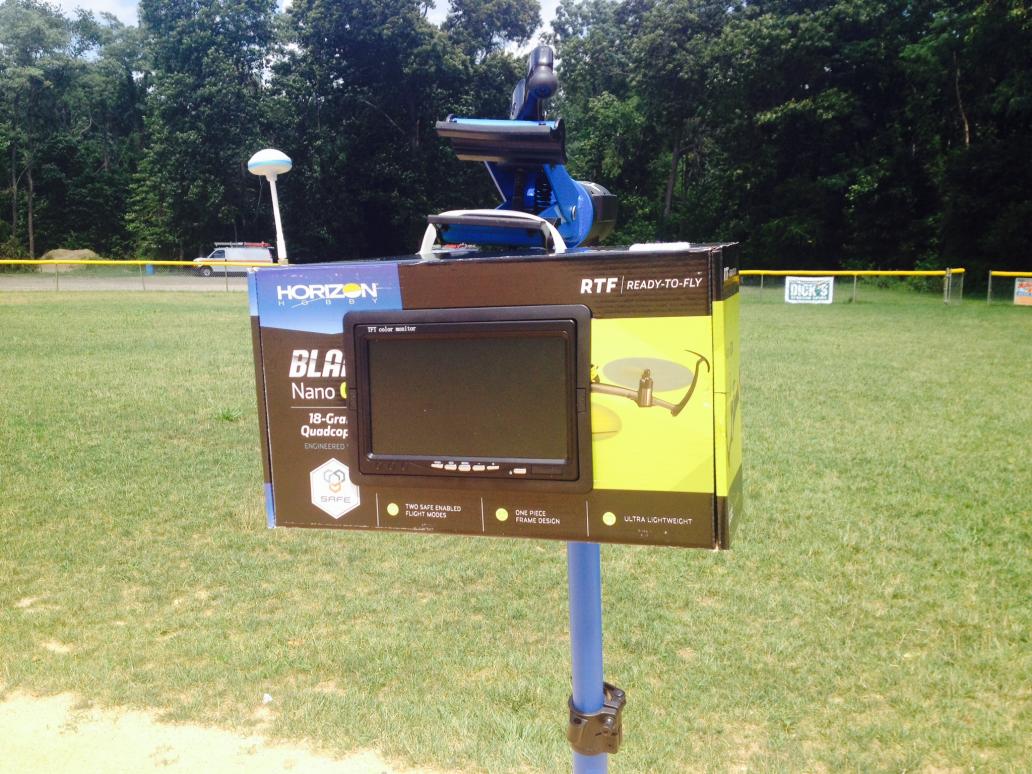

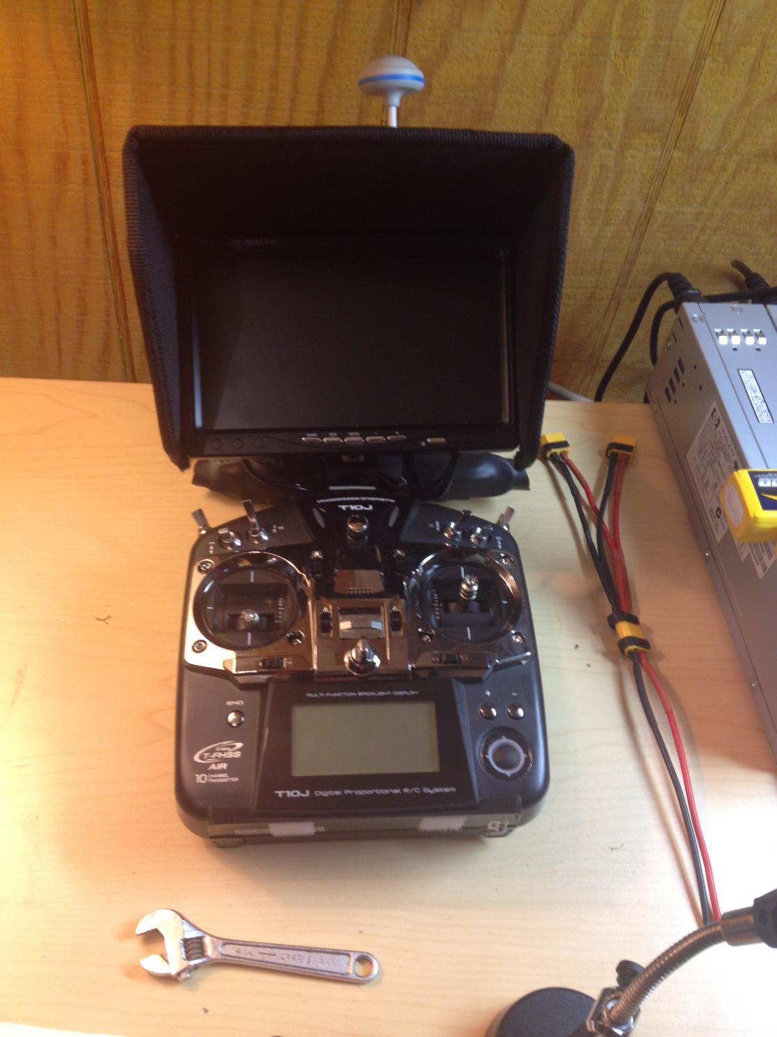

I initially had used a Park Tools bike stand that I had on hand to hold a custom box mount (see pictures below). I didn't want to go the goggle route because I'm a newer pilot and like to be able to use LOS flight often and quickly. That led me to mounting the monitor on the Futaba T10J transmitter, and there are a number of mounts that claim to provide this utility. Most are crap, but the one I settled on below, created by a small 3-d printing company, is amazing.
You can see the final product below. I wired an SD video recorder in parallel with the monitor so I can record what comes off the iOSD mini. Parallel means I don't have to lose an quality on the monitor, or deal with additional readouts around the edge of the screen.
