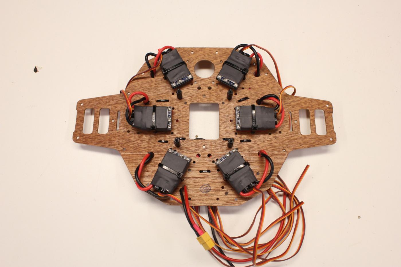

Yesterday my T15 with A2 flight controller dropped to the ground.
Short version about the crash:
I was flying about 300 meters from HP at an height of aprx 100 meters. Suddently the multi did a flip and stabilized about a second later. Then i put it into HP on the IOC and pulled the stick towards me to get it home. It then flipped and the motors were pulling it towards the ground at an extreme speed. I didn't have the time to try to go to FS or anything, it just smashed into the ground.

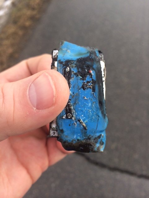

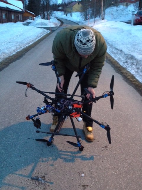

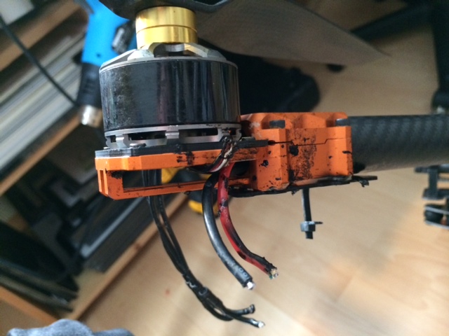

Burned all ESC and motors as it was stuck i the snow on crash and it looked like the motors still wanted to spinn. One of the ESC was actually on fire(!) and all thats left of it is a black/burned piece of plastic / metal. It burned of all cables going in / out of the ESC. The frame was ok and all the props broken. I suppose my motors also is wrecked as they have a quite a bit of resistance as I try to turn them around - almost as if there is some grease in the engines. All motors were smoking hot after the crash and the waterdrops which came in contact with the motors were instantly varporating.
Hope to save the FC, frame and battery. It looks good now, but I have no idea how to check the FC. It looks unharmed at least. Suggestions?
I've tried to check the Datalog from the iOSD but I'm not sure how to interpret the data. Does anyone want to have a look?
The .dat file is found here: https://dl.dropboxusercontent.com/u/31661823/Privat/FLY053.DAT
Curious about what caused this.
Sad way to end this years easter.... I think I'll be finding a new hobby :upset:

I know the wiring on the tarot can be a bit of a pain, was there any chance that there was a short or bad connection inside the frame for such disastrous results?

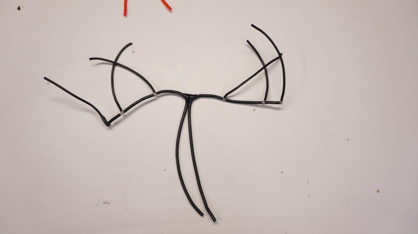

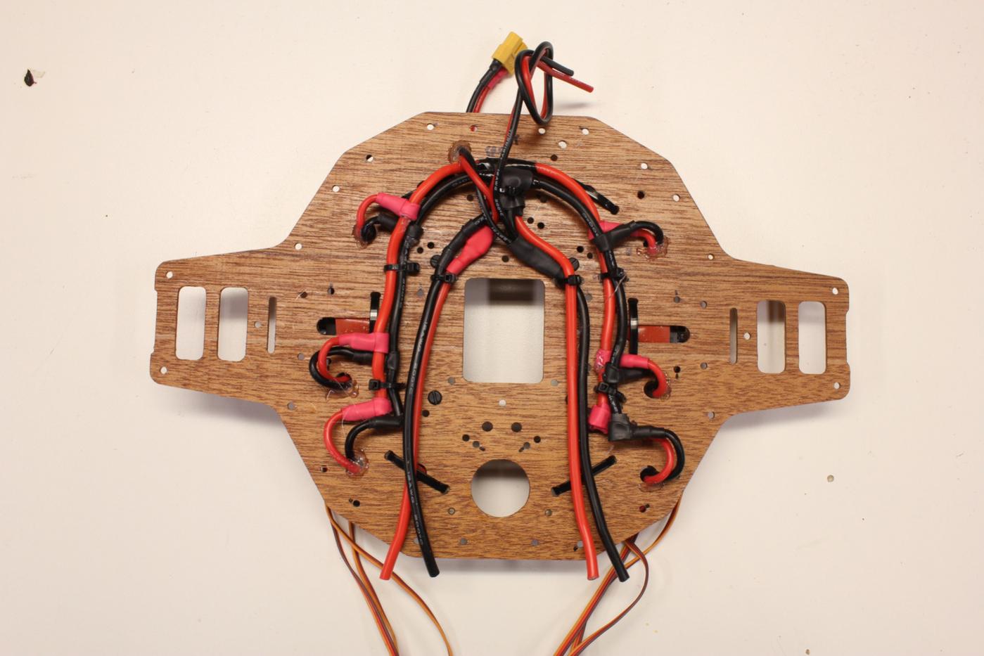

Now I've partly disassembled the Tarot and as far as I can see there is no short. My cabling was done through the arms and into a selfmade power distribution system (all wires soldered to 4mm copper rods).

Interesting. A short would explain everything, but I can't see what other explanation would result in the burned out motors and ESC fire. Could the short have been in the ESC that burned? If it shorted on the supply side then that would short the entire system. How did the battery look? Was it puffed up or evidently damaged?
