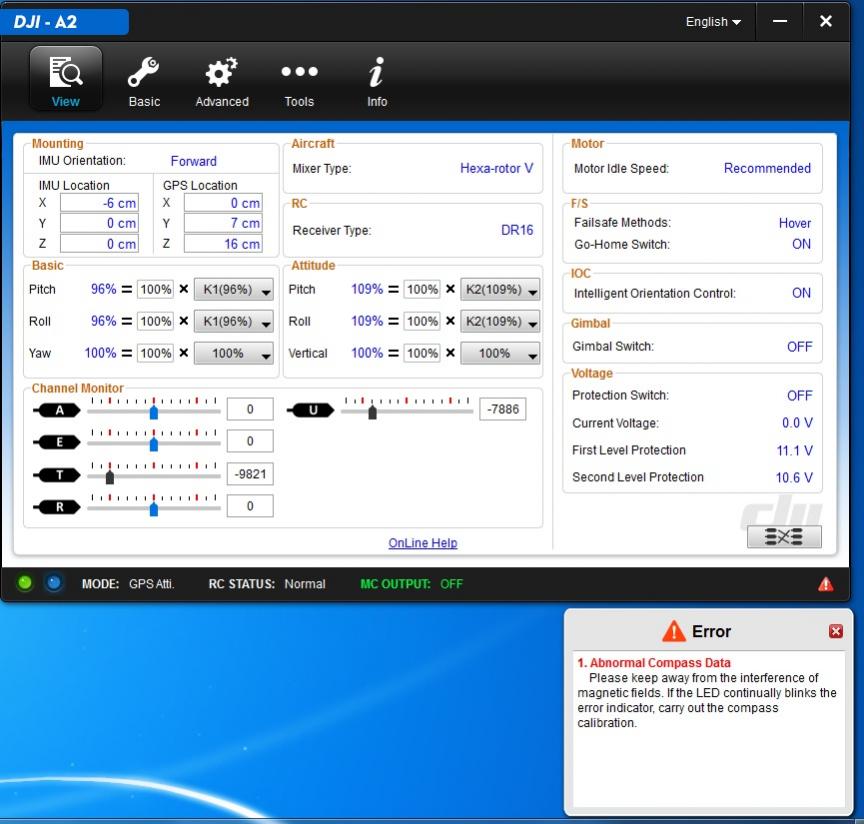

i found one of problems and i could go to calibration mode and calibrate my S800 until success. the problem is solved by configuring End_Point of the Control mode switch in my radio control, but after compass calibrating the error message "Obnormal Compass Data" Still uppers in Assist and i don't know what to do???
that is a snap shot of my Assist after Compass Calibrating:
Helirazor
Your gps location doesn't look right!! Unless you have it mounted under your craft...
