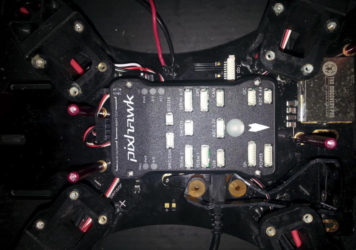

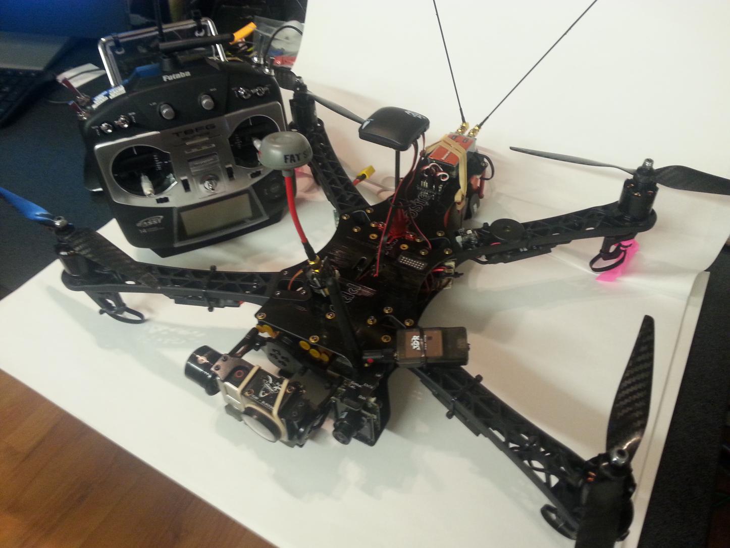

I'm swapping a Pixhawk in for a Naza now. I've only 2 Naza birds experience behind me. Flew it yesterday for the first time.
attachment.php
The hardest part for me was programming the Futaba to register 6 flight modes without giving up my only 2 position switch that I was using as a camera switcher. Had to reverse some channels to match the radio calibration screen, and then had to put them back to match how the MR actually flew.
The Pixhawk is much more complex than the Naza. Assume that you have 30 toggles/options for a fight; if one is wrong you may enjoy the kiss of gravity. If all toggles are correct, you'll have a rock solid highly programmable machine/system for many dollars less than the DJI/flyaway equivalent. Having the Naza experience first has made the Pixhawk easier. I would not recommend Pixhawk for your first build.
The Pixhawk direct from 3DR included the FC, the power module, and the remote USB/LED.
https://store.3drobotics.com/products/3dr-pixhawk
The remote USB ends in a heavy metallic port, so I butchered my gimbal vibration mount to preserve access to the USB in the side:
attachment.php
Options:
Ublox compass/GPS ($80) - yes! Or you'll just have a complicated Naza without being able use half of the flight modes or Mission Planner.
You may want to get the 3DR mast because it comes with a longer 6 wire cable. I had to trim the mast on my folding mount to make the stock cable reach. And I don't like how the short cable is exposed.
Telemetry Radio ($100) - probably. These work in place of a USB cable to feed data/missions to the FC. I haven't learned how to save the Radio configurations yet (despite using the 'Save Data' button), so I have to calibrate every time I connect. Did I mention the learning curve?
There are two frequencies available, so figure out which is allowed in the UK.
