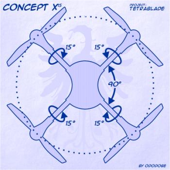

Concept X15: Standard X configuration with motors tilted inwards 15 degrees to aid in yaw control.

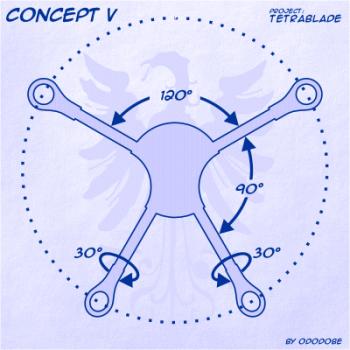

Concept V:Similar to a Vtail but with two rear arms with motors rotated inwards 30 degrees instead of mounted on a bent bracket on a single arm.
I don't see any reason why each of them wouldn't work and am especially keen to know if anyone has tried the Concept V configuration.

Im not sure about your X15 concept adn teh benefits of this but i do know for a fact that your Concept V idea is a very good one!!
OUr resident Copercontrol Expert Matwelli has built many with a similar configuration although he would recommend a 35 degree incline on your rear props although im sure it will work fine.
To use teh V Tail system you needa Flight controller that allows you to make your own custom mix tables.
Coptercontrol does this very well.
Search for V Tail quad and see what you find.
Most Versions of teh Vtail quad have one single rear boom and then the motors mounted in T fashion i believe thiswould be lighter.

I figured that the X15 concept was probably a wash but had read somewhere that the Mikrokopter 8 used a slight pitch to aide in yaw on their big monsters.
Perhaps 15 degrees was a bit ambitious but an angle maybe closer to 5 degrees might help and not take too much from the lift.
The V concept I feel would work well and a little extra weight would not be an issue as I don't envisage using it to carry too heavy a load.

P.S. I have since found a post that has tested a format like Concept V http://www.rcgroups.com/forums/showthread.php?t=1338634 .
While it looks unstable in the "decent wind" that he is flying it in he also says that the flight controller wasn't the best.
I am sure that a more up to date controller such as CopterControl would be able to handle the configuration as well as it does a
normal V Tail Quad.

I forgot about this thread i did see it a long time ago.
Yes i am sure the Copter control would handle it much better as you can control the motor mixing table to get exactly the control characturistics you need.
Good Luck!
