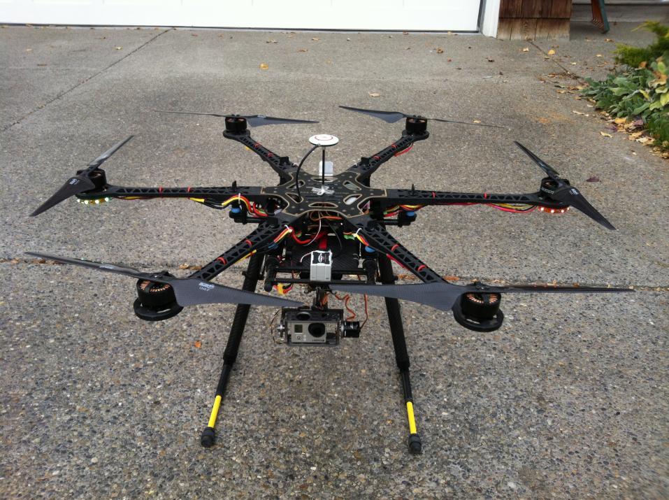

I started off with the Flamewheel Hex F550 then decided I needed longer arms to accommodate larger props with better motors. So I ended up going this way and with no regrets. http://www.rctimer.com/product_809.html
Chose these motors http://www.hobbyking.com/hobbyking/..._4830_420Kv_22Pole_Multi_Rotor_Outrunner.html and Turnigy 30A Multistar ESCs.
Later added two axis brushless gimbal and added the Hero GoPro...... logged over 150 successful flights and still hanging on to this nice flying machine.

I just build an F450 to just kind of stick my foot in the door of aerial video, and i could not be happier!
No matter what you end up choosing, going from a small quad like the Blade to a bigger quad is tons of fun!
I really do like the naza with gps. Its super easy to setup and makes flying fun. If you do end up going the f450/550 route, i would definitely start out with some better motors than the stock motors included with the ARF.
Also Scott, thats a pretty awesome looking rig! What size props are you using on those multistars?
