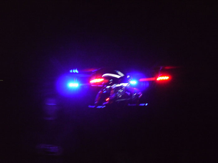

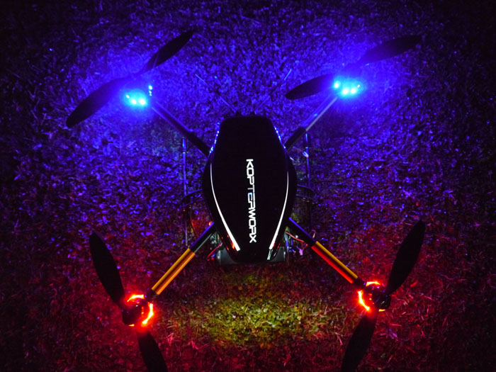

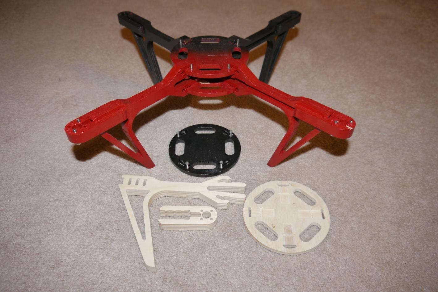

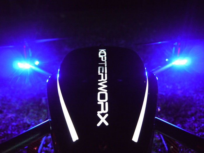

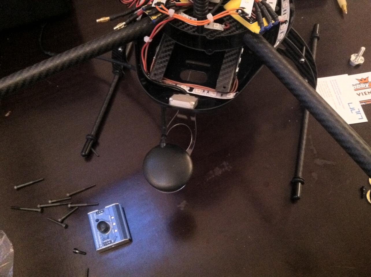

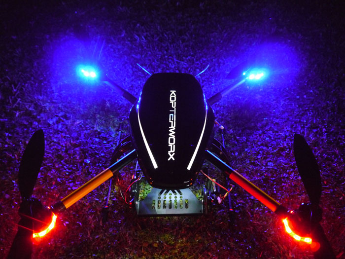

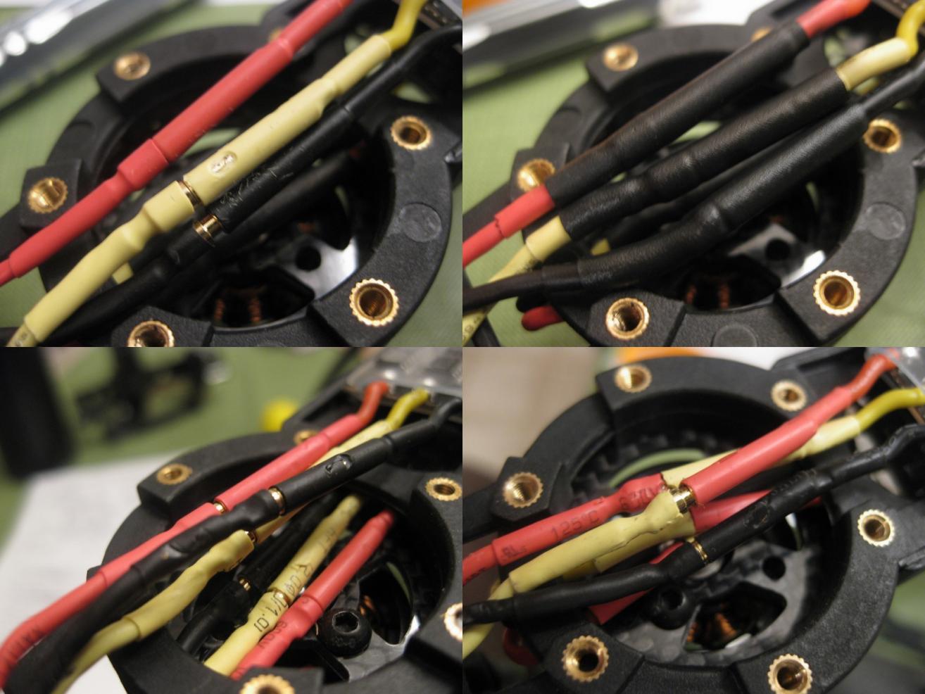

New build:
CX4 with KW4 motors, Herkules II board, MK electronics, 5s 5000 mAh lipo, props 12x3.8 carbon, CX4 mount
Flight time 18 min with gopro.
Max payload 1,2 kg.
View attachment 1757View attachment 1758View attachment 1759View attachment 1760View attachment 1761View attachment 1762View attachment 1763View attachment 1764View attachment 1765View attachment 1766
Max payload 1,2 kg.
