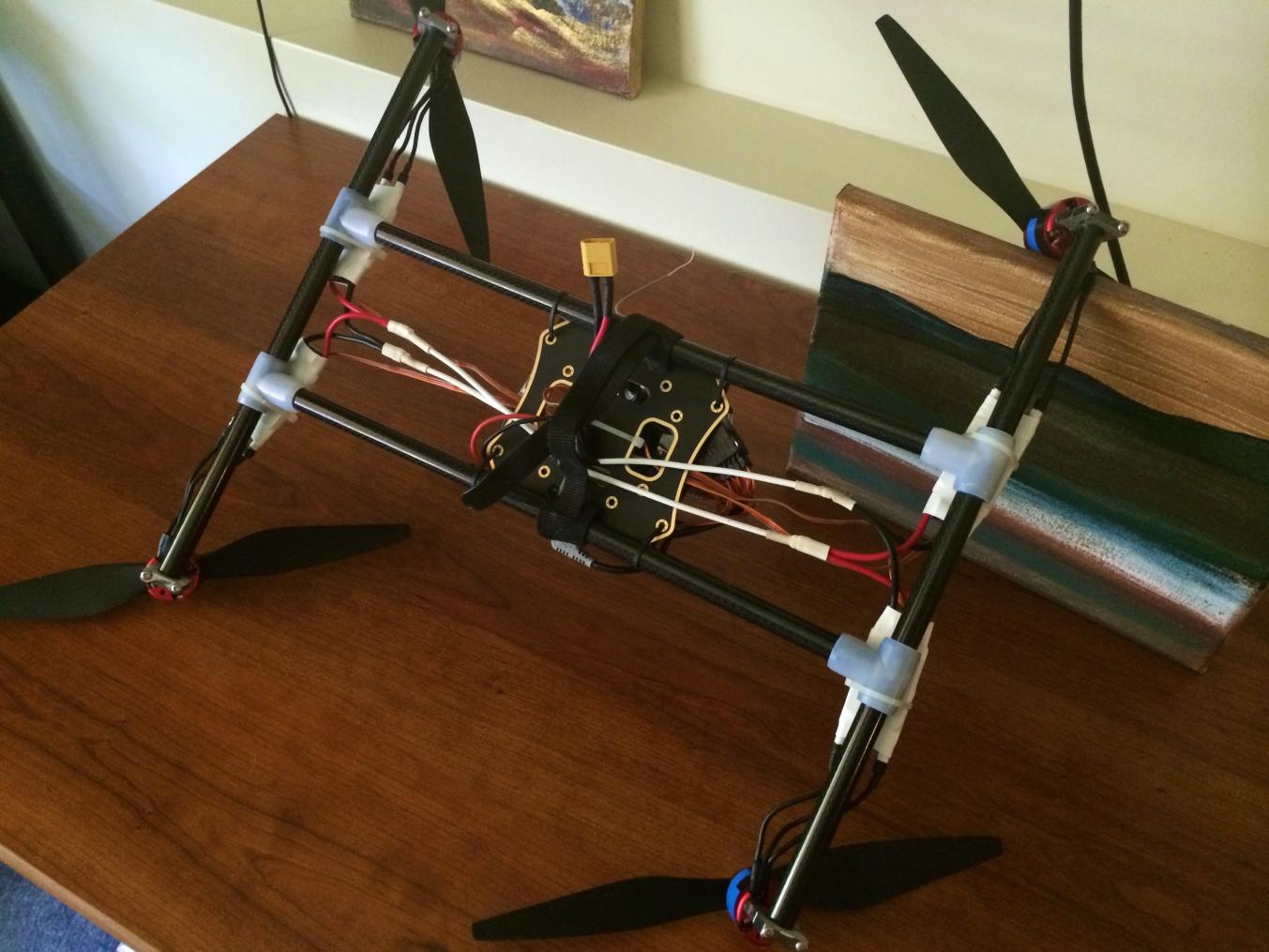

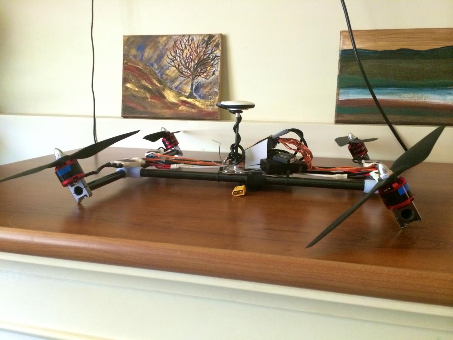

So anyways, here is my theory put into practice. What I've noticed with other tilt rotor quadcopters out there; the designer does not make the gyro board tilt along with the rotors. On my angle quad, I tilted and fixed the rotors to 30 degrees and made a mount to hold the Naza V2 at a 30 degree angle inline with the rotors. It's kinda like tricking the gyro into thinking the quad chassis is level, but instead, you have this wicked looking tilted hovering machine, but the whole main purpose of the tilt is so when you give the quad forward flight, the chassis levels out and reduces drag for fast forward flight.
This is just a test bed, I threw it together just to see if it would fly (and YES it flies excellent!) I built the frame out of Trex-450 carbon tail booms and some cut down nylon tee fittings I found at home depot.

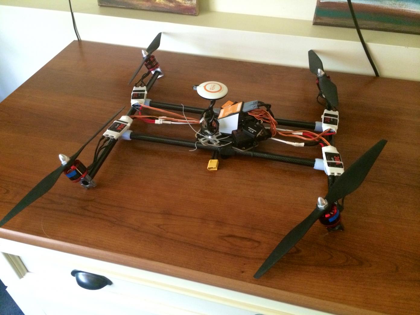

The electronics are out of my DJI Flamewheel 450. Naza M V2 with GPS and PMU, All DJI motors and ESCs along with carrying a 5000mah 4s 20c battery.
The simple carbon frame saves ALOT of weight compared to the Flamewheel 450 frame. In manual mode, the quad will hover at 1/4 throttle. This leaves more room for video equipment and gimbals.
This quad is super fast in manual mode. In GPS or ATTI mode, you can just tell its a lot more efficient, but because of the throttle and tilt limits in GPS or ATTI mode, its not nearly as fast, but the flight time should be longer because of the weight savings and reduced drag.

P.S. The Nylon Tee fittings from home depot are awesome! Super strong and they only need to be cut down and drilled out with a 1/2" drill bit to accept the Trex carbon boom. I scratched the carbon at the glue point and applied epoxy with micro balloons. The carbon will snap before the tee fitting does.
