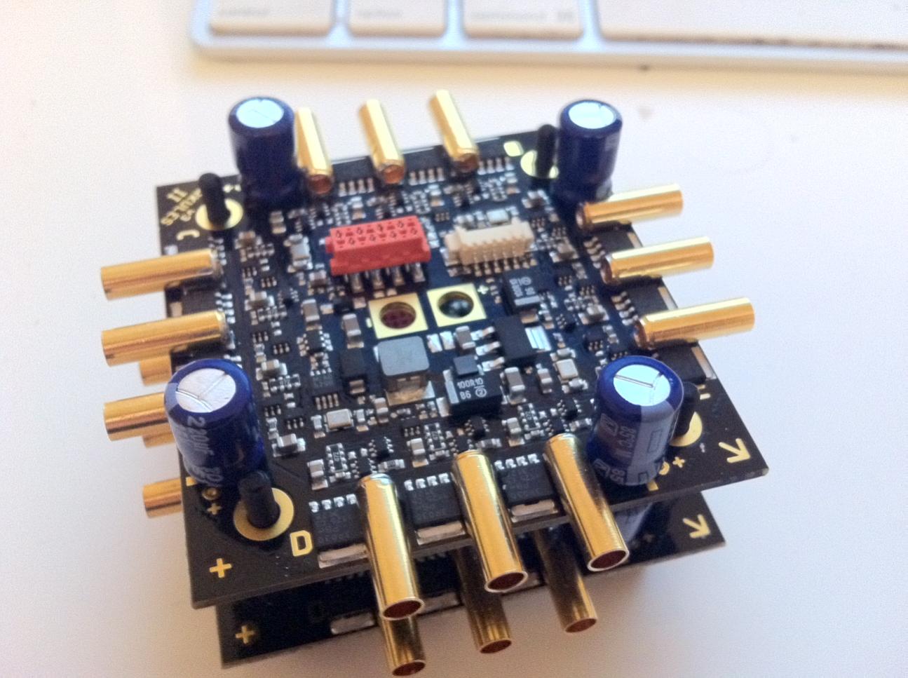

finally have these babies, gonna spend some time configuring them today. Really looking forward to these !
plingboot
they look interesting - make for a nice clean build too - i assume you're stuck with multiples of 4 motors?
can i ask how much?
Not sure what you mean with multiples of 4 motors sorry my english is not that good, although it should be after 10 years on an international school :)
But I guess you mean that i will need two boards for a Octo and one boards equals 4 ESCs
These are i think still test boards or a pre release of the final version not sure. Price at the moment are based on personal arrangement, i don't want to comment on it since i don't know what the actual price will be.
But write andreas baier a mail he is a nice guy.

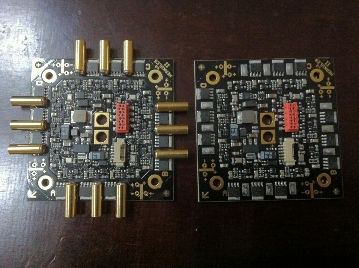

puh, alle bullets soldered flashed to ppm 24 DEG and Free Wheeling on, gona finish the cables for the actual Singnals and than I hope finally my CS 8 kit will arrive.
Don't you just hate waiting for stuff? It drives e crazy!
has its positive and negative sides, although only one positive. If Id have everything here i would probably be doing 5 things at once and not concentrating on one thing.
ovdt
Boris, I'm very excited to see the results of your setup. If Herkules II works with DJI W-M much better than standart ESCs, I'll be very glad.
Wow! Can't wait to see how this performs. The Bullet connectors on the ESC are a nice touch, very pro / industrial installation.

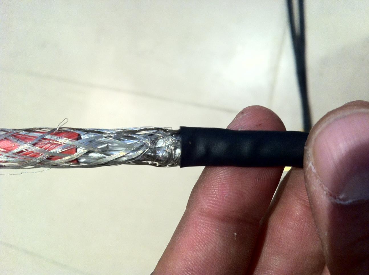

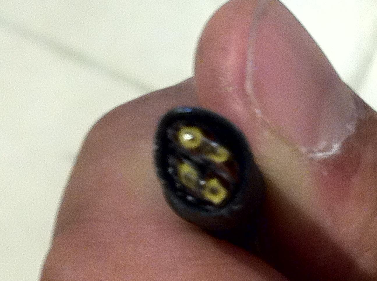

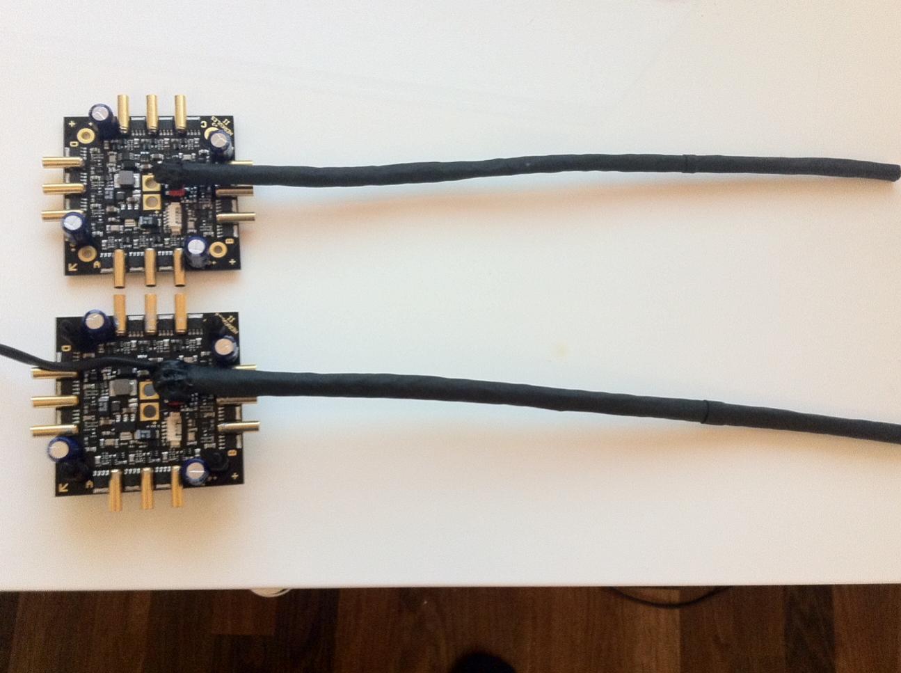

2 x cat 7 shielded 4 x servos silicon cables coming from the herkules II (micromatch connector) to the WKM MC , for the ESCs signals. Not sure if the shielding really makes a difference but at least i have a rock solid connection/cables. Eventually the cables with split up into 4 shielded servo cables until the futuba male servo plug.
