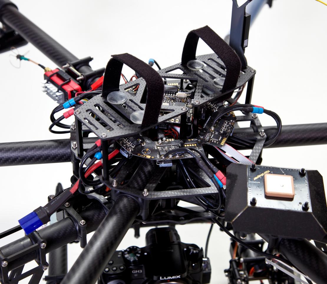

Just built my first quad. Hobbyking x650f frame, 1000 kv motors, 10" props, APM 2.6 flight controller. It flies, that's the good news. The controls seem hyper sensitive, is there any way to change settings in the APM to reduce this sensitivity? I have a Hubsan X4 that has a basic fly mode that makes it much easier to fly. I have the APM set to stabilized mode, is that best for beginners? Thanks in advance for any help
