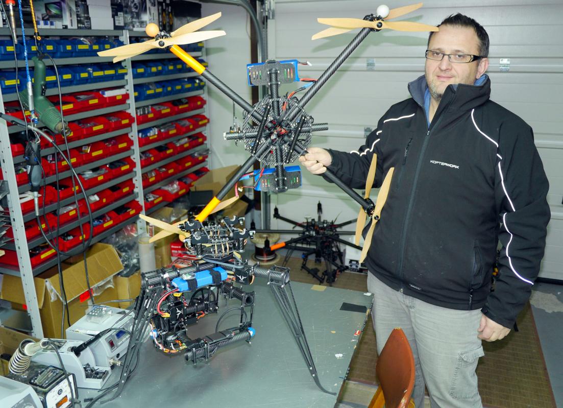

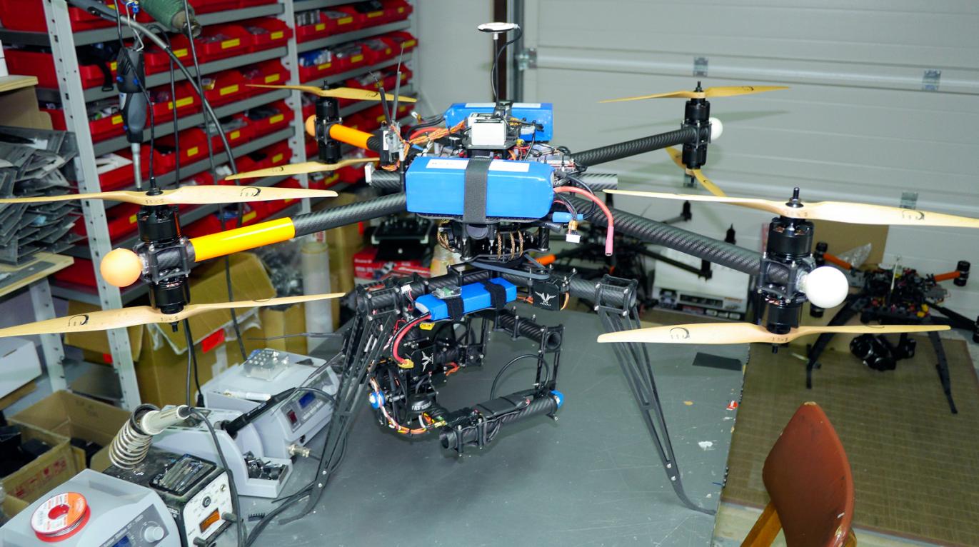

This is Maiden flight of cinestar X4 with KW10 motors.
Save payload up to 7kg.
Cinestar gimbal with some improvments (closeup pictures coming soon), radian stabilization.
We had only GH3 at Kopterworx, so we put it in.
Fligt time with red arround 13-15 min with 4 akus arround 20 min.
Next video will be with Red Scarlet.

Very cool. So why go with the coaxial prop setup over a normal Octo configuration? What benefits do you see from this configuration?
krleas
FPV Freak
More stable, smaller, u can use our heavy duty motors with 16 inch props. Tell me how big must be okto for 16 inch, this ones go to box 80x80x50 cm.
Tuukkuli
I would like to have the coaxial system like in this thread because I fly Wookong. Do you have the necessary parts for that in your web shop in the future? Is Cinestar-6 the frame the mod is based on? Thanks.
Kilby
I would assume the CS8 frame plate is the basis of this build. CS6 would be used to make a Y6 config like this. 90 degree vs 120 degrees.
