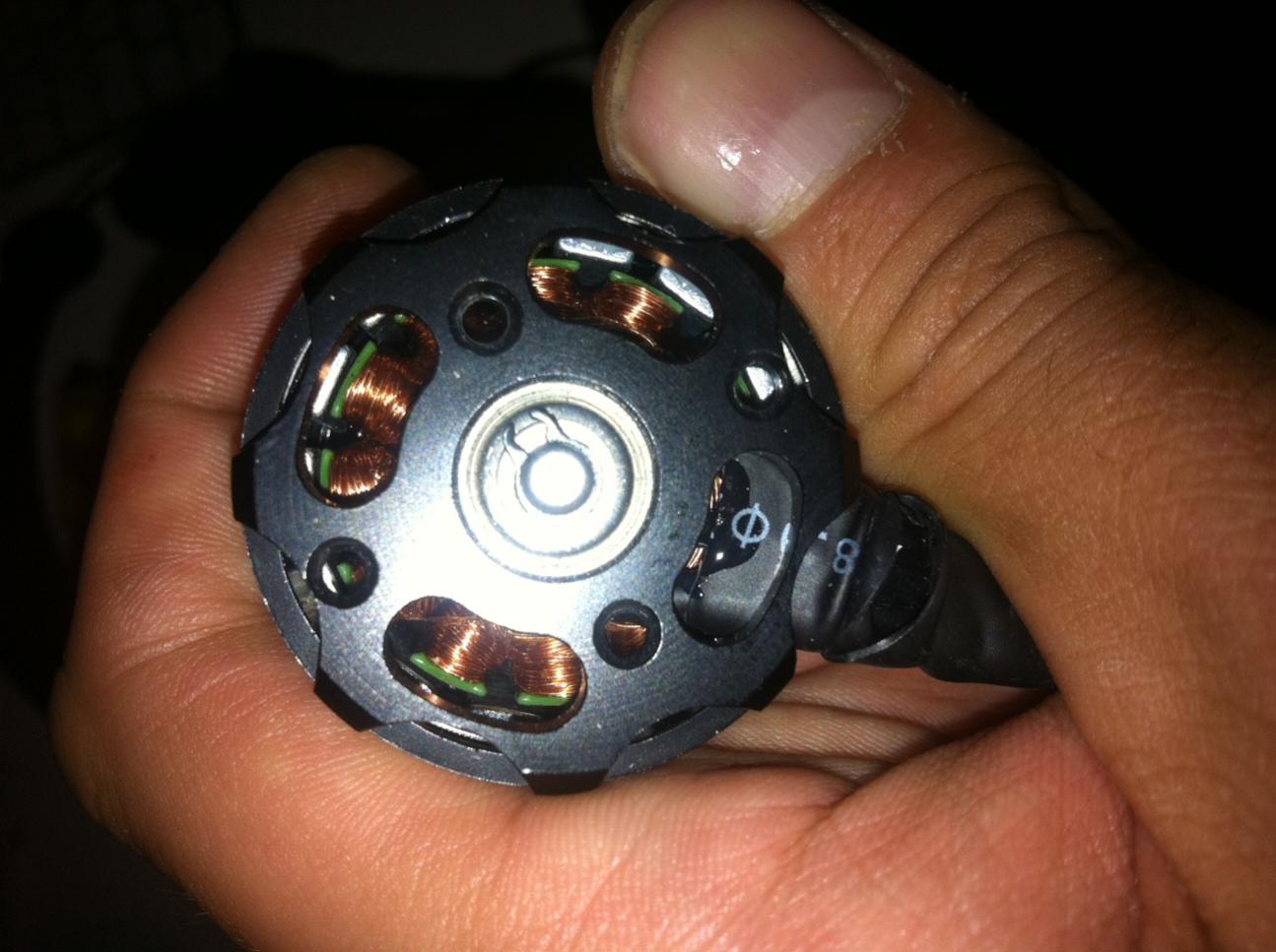

I am building the cinestar 8 together with AXI 2814/22 Droidworx motors. The problem is that the mounting bracket from cinestar does not match holes at the bottom of the motor. Out of 4 holes I am only able to use 2. Do you think it's going to be enough to hold the bird? Don't want the motors to fly away without the frame once I put some heavy weight under the booms ;-)
here are some images
http://flic.kr/p/bzVToC
http://flic.kr/p/bzVTk3
http://flic.kr/p/bNQxbx

the plettenbergs even the 3.2 KG thrust ones are mounted with two screws, but best is ask Rtryder since he has as CS 6 Axi 2814 / 22 setup. Cant believe that the droid worx edition is different.
Boris

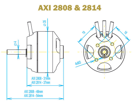

osiris
They are definitely changed...now the distance is symetrical on both sides. Funny is that the leaflet and the manual does not even contain the schematic of this new /22 model...only up to /20. Even the website www.axi.cz has no mention about /22 ones.
Well let's hope they last. Will see soon. Just waiting for Flight Controller as it was missing from the order :-( so I can continue the build.
