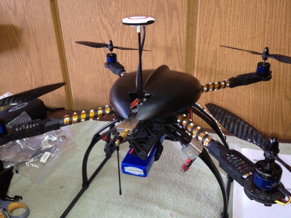

Specs:
Cinestar 6 frame kit

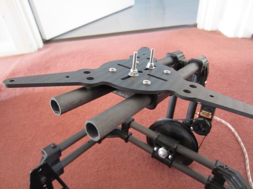

Modified Photohigher Fly Pod AV200 - 360 camera mount
Dji Wookong autopilot fc
Torxpower 3536 Pro motors + Hobbywing Pentium 40a ESC's
Spectrum DX8 tx - AR8000 Reciever and TM1000 telemetry module

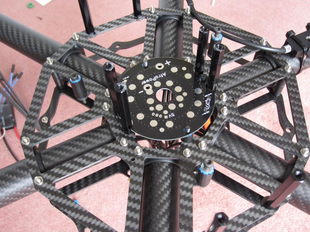

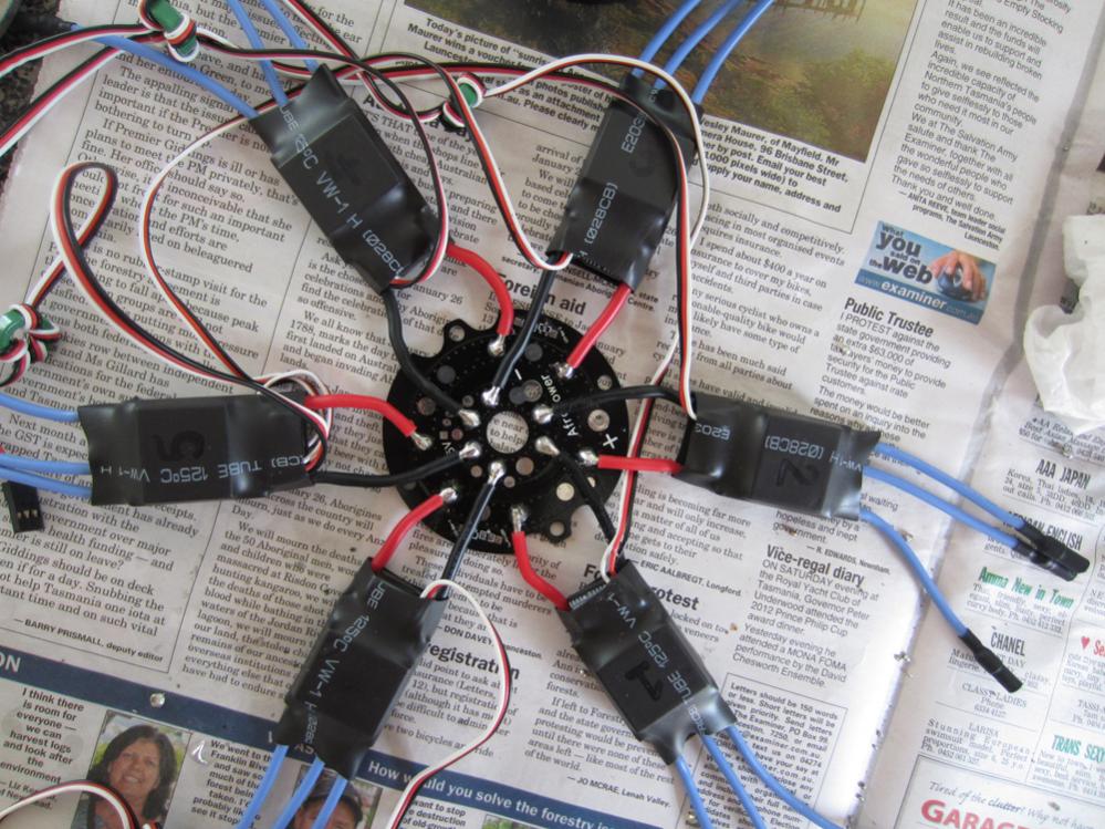

Afropower distro board
2x Turnigy Nanotech 5000mah 4s and 2x Turnigy Nanotech 4000mah 4s batteries.

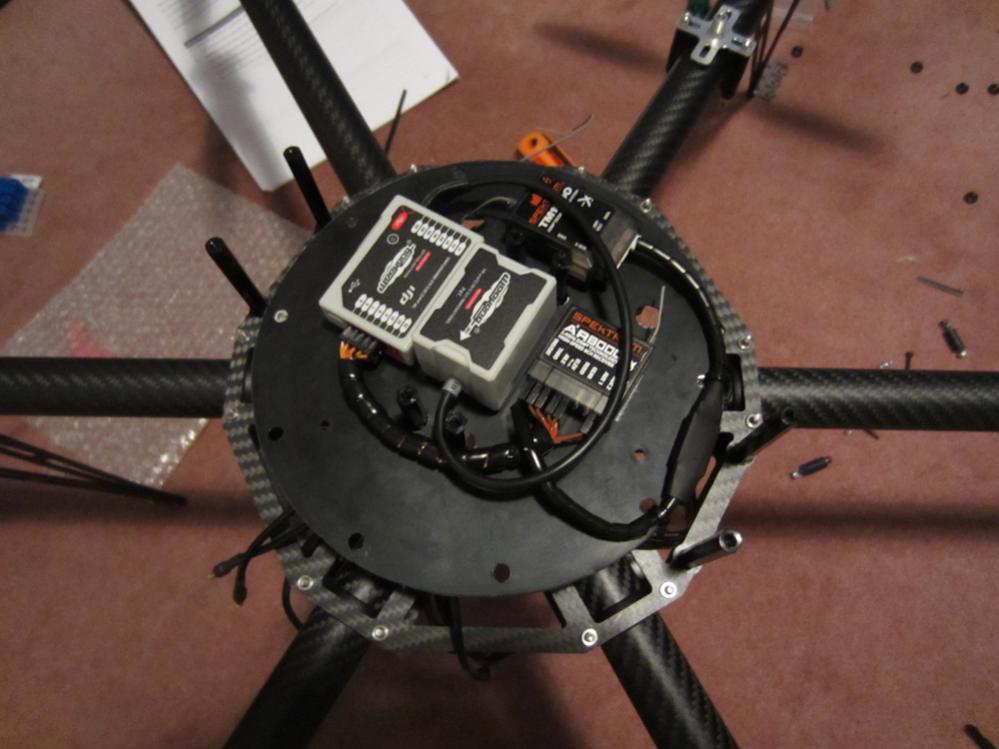

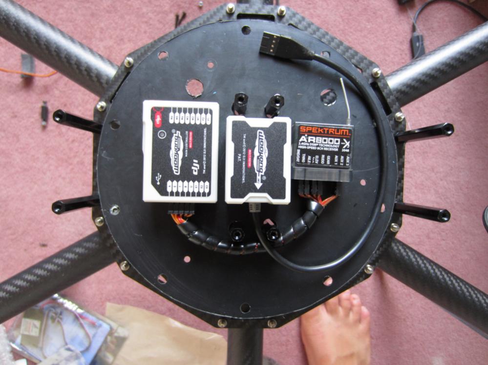

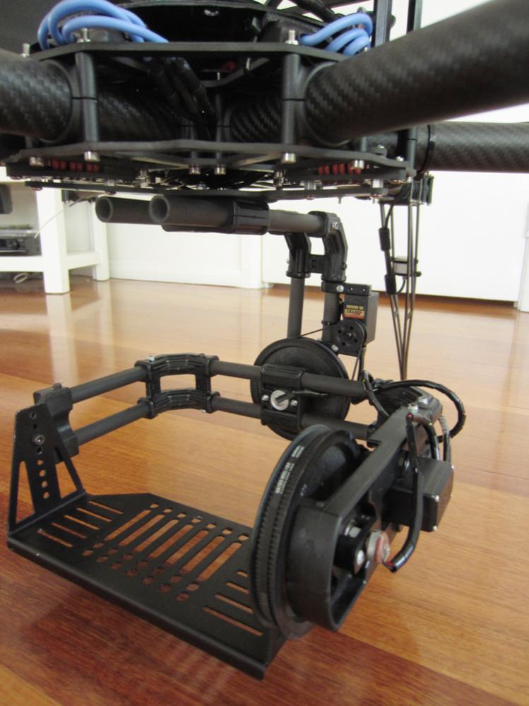

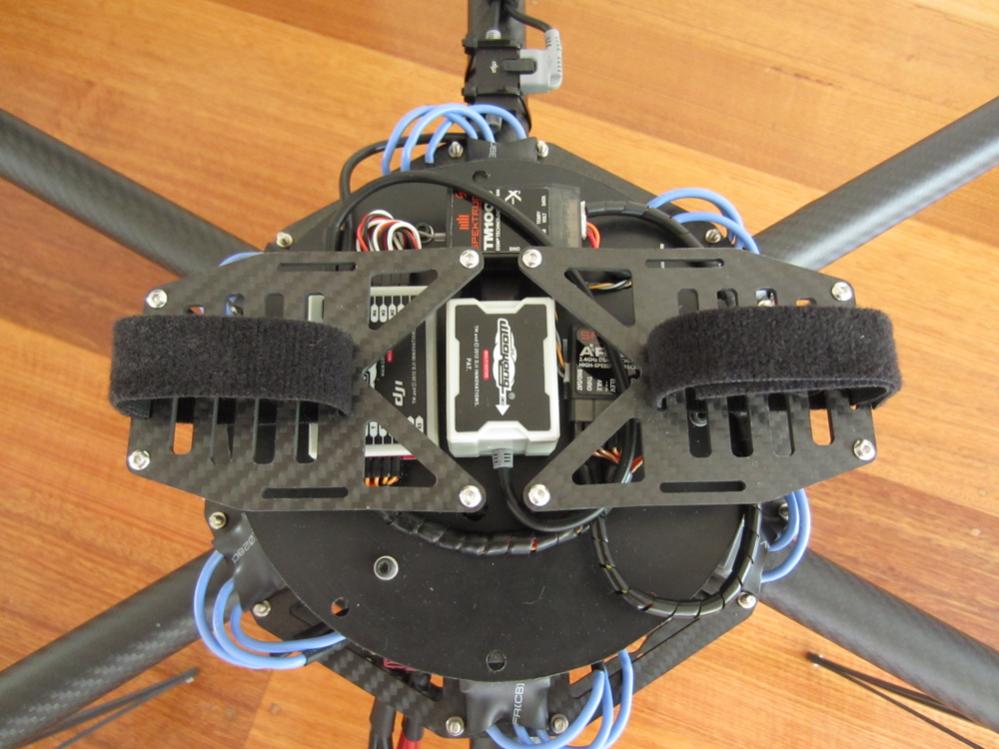

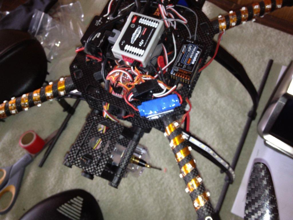

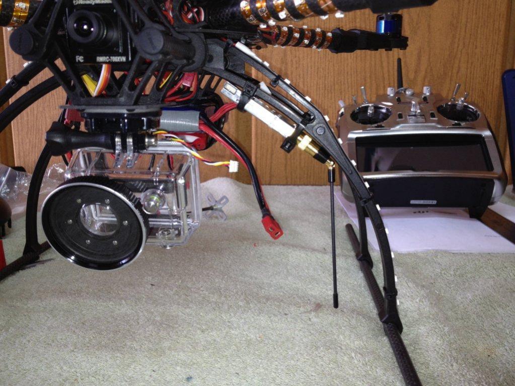

Basic flight control layout

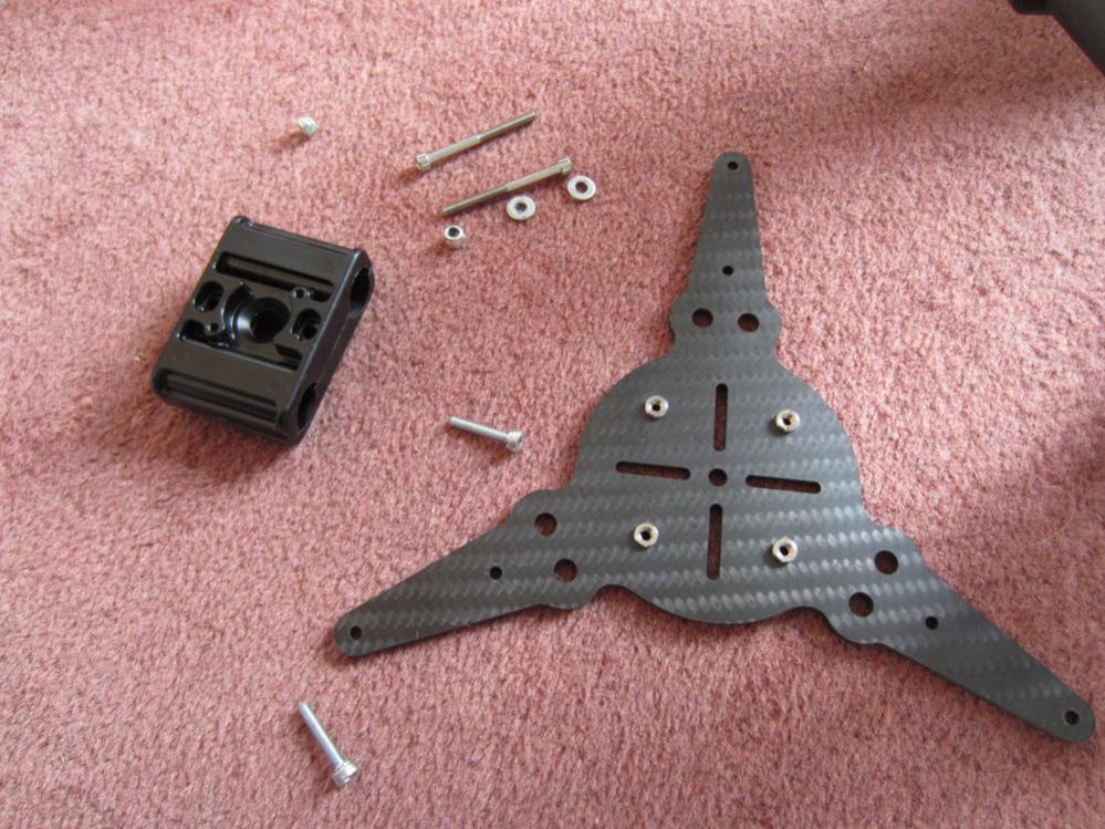

Top mount from photohigher camera mount and cinestar camera mount plate
Match made in heaven
Telemetry moudule in place
Just some small notched taken out from the distro board and it fit in well.
View attachment 2206View attachment 2207

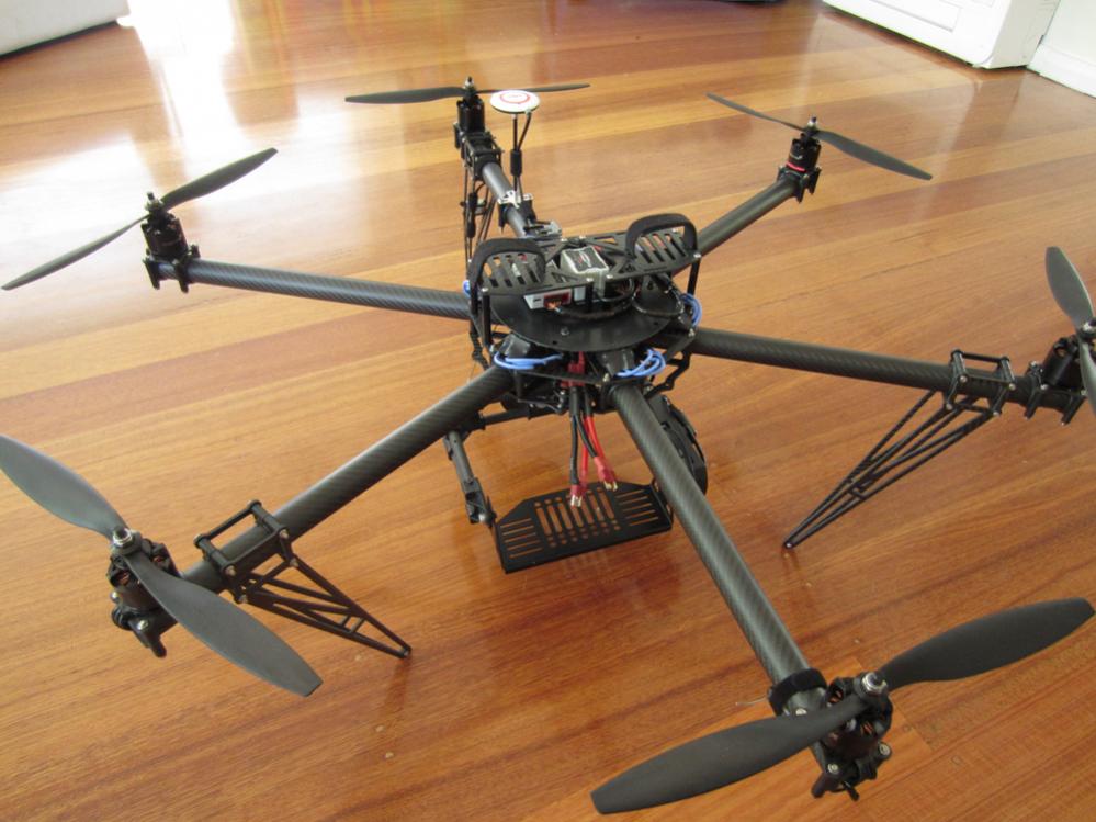

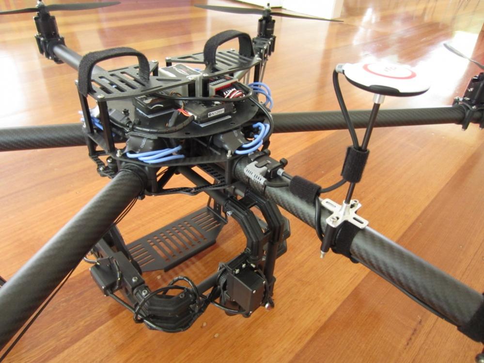

All built and ready to fly. Have only done some basic gain testing but it seams to work well.
Waiting on cc bec pro to power the camera gimbal and also waiting on some apc 12x6 thin electric props. The ones I have are two flimsy and vibrate a lot.
View attachment 2208View attachment 2209View attachment 2210View attachment 2211View attachment 2212
Thanks to Ken for all his help with my noob questions and also everyone who has gone before to trial components. Make's purcashing parts less of a stab in the dark.
Stay tuned for some sample video within the next few weeks.
