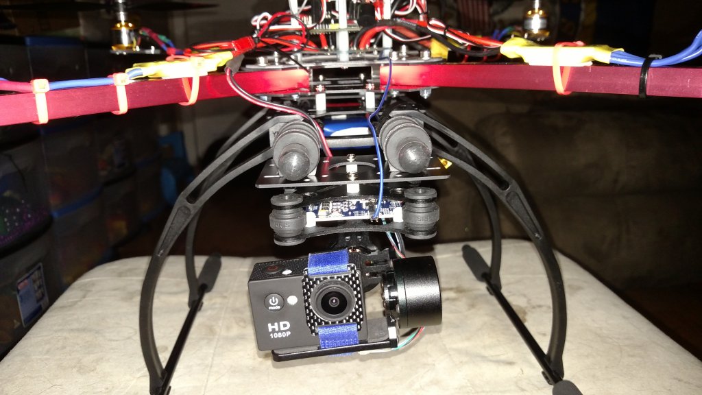

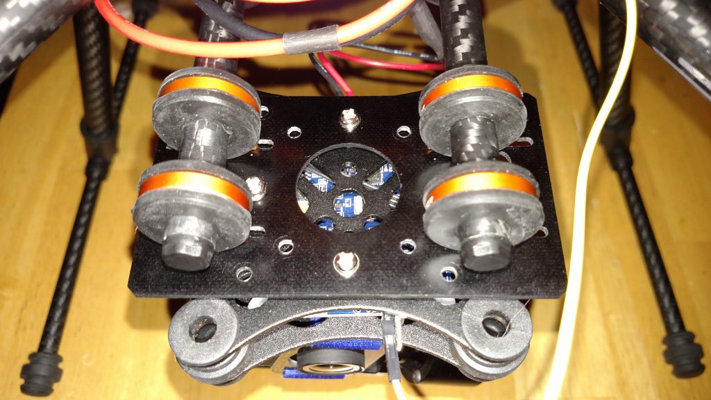

To eliminate the jello you need to isolate the entire gimbal and its mounting plate from the aircraft frame like I do with my Tarot 680 Pro and my "el cheapo" X-525.

I used the X-525 as my test bed, and with the double isolation I had zero jello. When I built the 680 I used Tarot's hook mounts and got jello like you wouldn't believe.
Now I use the hook mounts to hold the battery tray.
