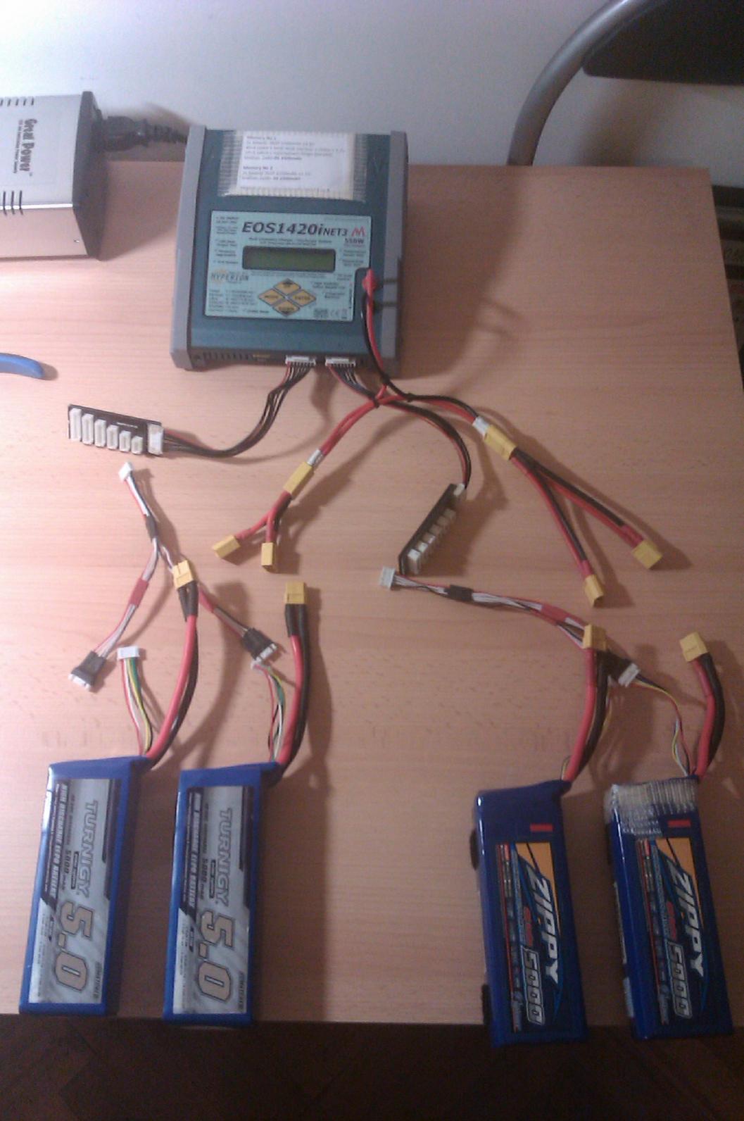

Have Hyperion 1420i net3 charger with 2 separate balance board A and B. I use my batteries in parallel 2x 4S 5000mAh for my octo and charge them in parallel mode. I would like to charge more than just 2x 4S in parallel at the same time. So my question is:
If I have 2 packs 4S 5000mAh (2x 4S 10000mAh) wiring in parallel. Could I charge them all in series? Or another way can I charge two parallel wiring batteries (2x 4S 5000mAh) together in series?
If I can that must set on charger:
8S 10000mAh, right?
parallel = 2x 4S 5000mAh = 4S 10000mAh per pair
put two parallel set in series then it would be 2x 4S = 8S 10000mAh.
here is image what I want to ask.
I'm asking because of limitation of hyperion charger. max 20Amp 550W. Thank you for any help.
