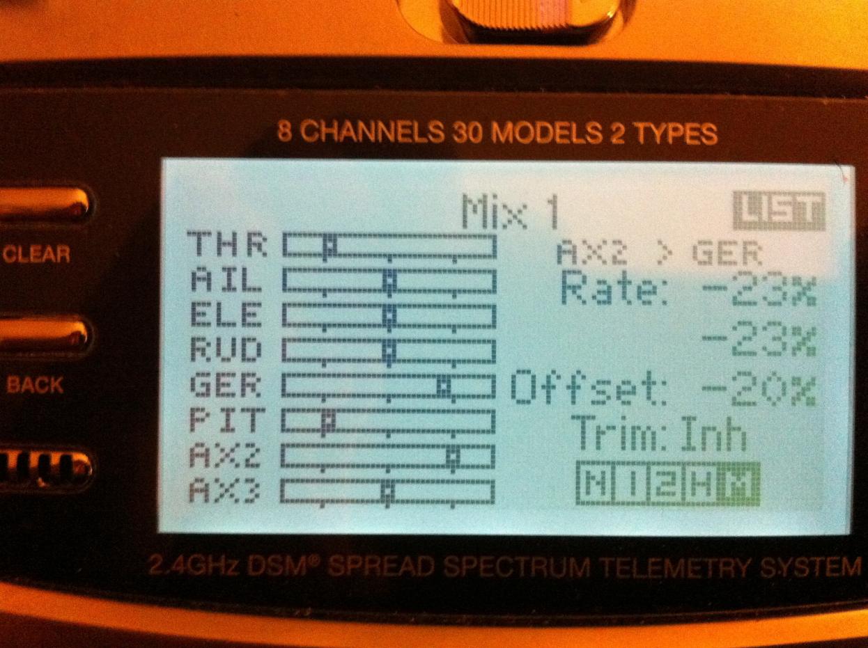

I have the wookong all set up with my dx8, but i cant get a mix to work like it does on my naza for failsafe? any ideas
Got a mix made so that i get failsafe in gps and manual mode, but i cant figure how to get it to go in failsafe in atti/middle switch position. Ive tried messing with the rate and offset in mix manual with no luck... Am i beating a dead horse. Should i settle witg failsafe activation i. Gps and manual only, if a real failure happens ie loss of signal then it aswell goes in to failsafe, guess that's most important lol

Here is how I have my Naza set up on a 9503 which is similar.View attachment 3006 You can mix the Aux 2 with the Fmode switch if that is how you have it set up. Hope this points you in the right direction

Kind of, but i wanted to keep auxiliarys free for gain tunkng and gimbal adjust, can i not mix from my mix switch into gear or wookong u channel
