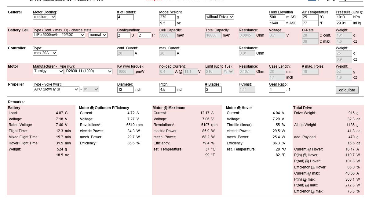

Here's ecalc is telling me
Turingy D2339-11 1000kv
2x 5000maH 2s 20/30C (cheap)
20A ESC
Slowfly 12x4.5
Mixed flight time 15.7 min
Hover at 55% throttle
Additional payload 470g
Temps below 100F
My concern is that in most of the build threads ive seen people are using 8inch props on 1000-1200kv motors. Will 12inch props even fit on a a450 frame. I love the flight time but I don't want it to be too slow.

You have set the model to only weight 270 grams, a setup like this would be more like 1,500-1,700 grams and more depending on your load.
You have set your battery to 5000mH rather than 10,000mH which it would be for two 5,000mH packs.
Not sure there is such a motor as you have listed, there does not appear to be such a motor listed at HK.
Pete
jes1111
"2P" indicates two packs @ 5000 each, so that's okay. But 2S packs, really? That could be why 12inch props are not overloading the motor ;)
Frame does seem very light at 270g but AUW is showing as 1185g so it could be right.
